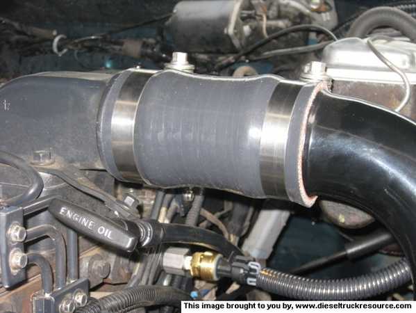

Old Mar 6, 2011 | 04:26 PM
blackfordd's Avatar
Joined: Jun 2009
Posts: 495
From: Torrance, CA
Here's a picture of the banjo, needle and sensor.
