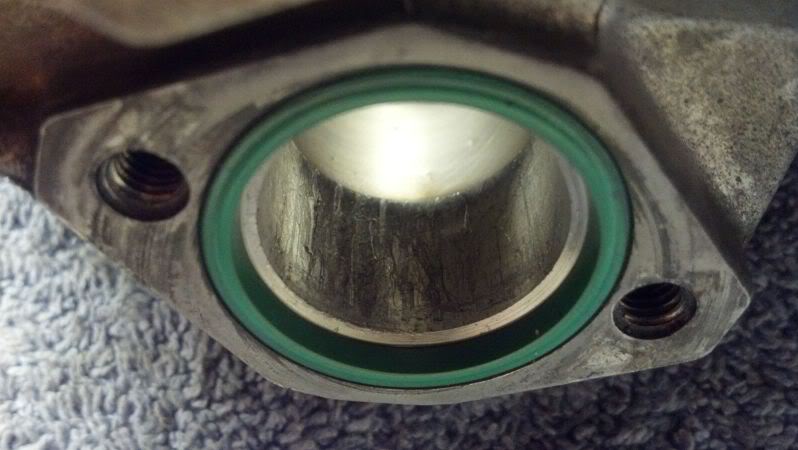

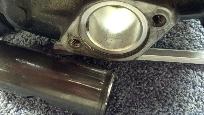

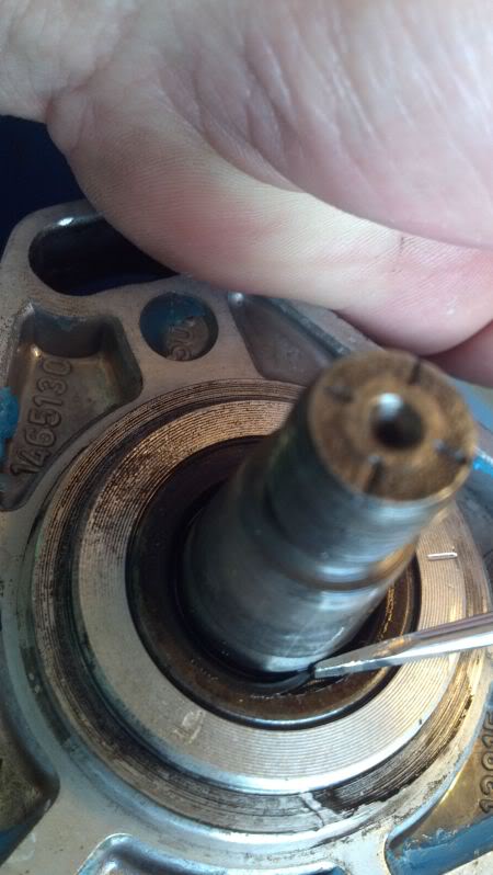

finally got the pump pulled today. just for the record:
i have 1.5 DGK121 pump re-seal kits, a nice regulator, and a -ton of fittings to rig the regulator. should have him buttoned back up by next weekend! i miss my rig!

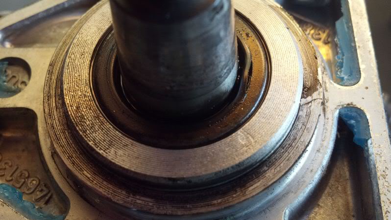

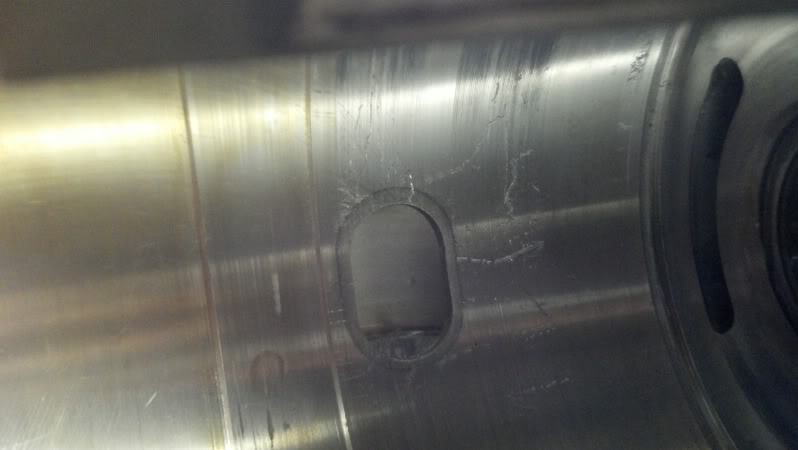

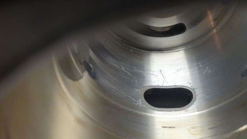

some people should not be allowed to own tools!
KSB piston bore:
other side:
pump body main bore:
Old Oct 23, 2011 | 03:55 PM
wheelieking71's Avatar
Joined: Feb 2011
Posts: 221
From: Gilbert, AZ
here is the cause of the tore up KSB piston bore:
some gorrila with a hammer had a good time. so now i get the reassuring fact of knowing i rebuilt my pump when the main pump body is JUNK! YAY!

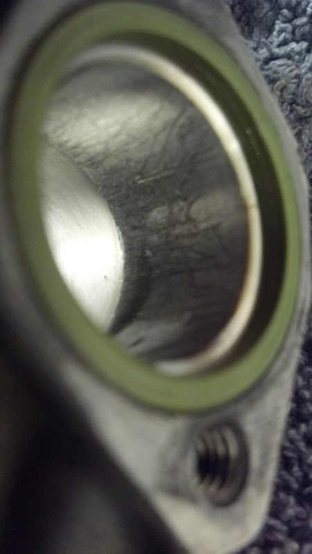

Old Oct 23, 2011 | 04:33 PM
Joined: Feb 2011
Posts: 221
From: Gilbert, AZ
i just filed all the high spots off the piston, and ran a small wheel-cylinder hone through the bores. its not perfect, or ideal, but its gonna hafta work:
the piston now fits well, and moves very smoothly with zero binding, and very little percievable "slop". my calibrated finger comparators tell me i now have about a .005" slip fit. i hope that provides enough of a seal to overcome the spring.
