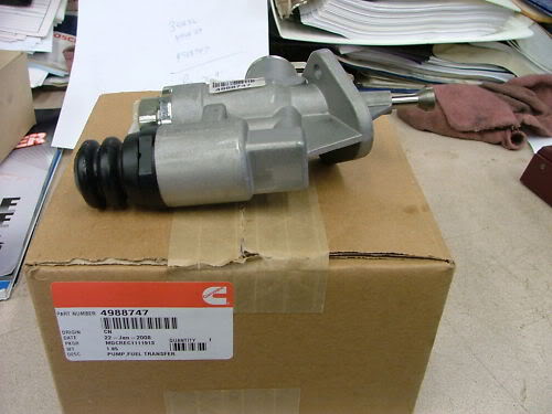

2nd gen. part number: 4988747

Im betting that there is your problem and blew put the front seal. Ya gotta run a regulator with those 2nd gen piston pumps and keep the fuel pressure below 15 psi or it'll blow the seal. Some guys will get away with more pressure but its all in luck and how new your pump is.

Just to be clear, you evidently have the higher pressure piston lift pump. Can't tell if you know that there is a low pressure piston lift pump that is the one that should be used (unless you want the high pressure one). The low pressure one doesn't need a regulator, doesn't blow your IP seals.
It's your call, but it looks like after fixing your IP, you can either regulate the high pressure LP or get the low pressure LP and not regulate it.
