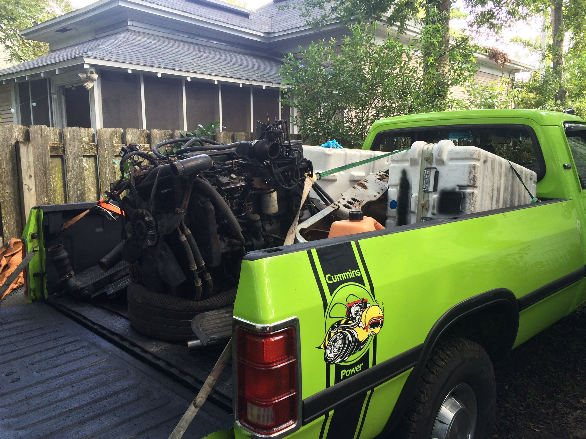

Does the below pic ring a bell or did the included goat fog your head.
Originally Posted by j.fonder
Need I publicly remind you that you sold me this lemon of a motor? Maybe I should start a thread explaining to the fine members here at DTR the problems I've had with this POS "low miles, perfect" motor you sold me. Can't trust anyone these days.

Proof that it was once your possession.

Busted....but thanks for the tires
