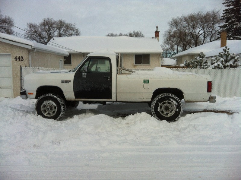

Well I got mine in with my el cheapo taller shocks and hummer wheels. They look to be real high quality, only thing that bothers me is the shackle they send does not have the same center to center for the bolt holes.
Hopefully they're longer by ~ 1/2"?
If so, that's not a bad thing. It will allow the springs to flex some more.
--Eric

I worded that wrong, they're longer shackles with the springs that replace the factory ones, but the bolt hole centers are not the same on the new shackles meaning the bolt has no choice but to go in at angle. I didn't have time to make new ones.
