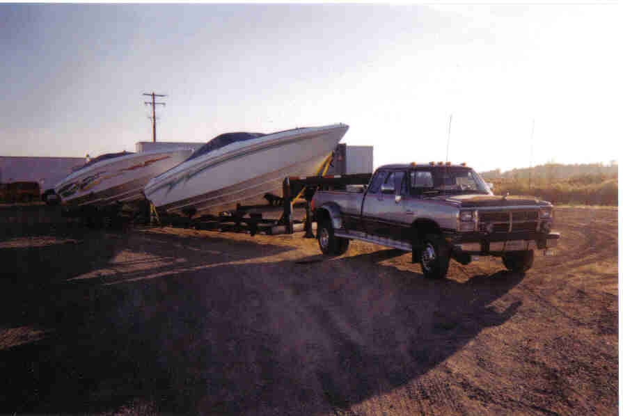

If so here it was many years ago when I was hauling commercially... The front sits much higher in this picture than it does now with tired springs...

1.1MILLION!!! Standard or auto trans? Rebuilt engine/trans/drivetrain???

At 95K something went kaput in the engine, so I got a brand new surplus engine... Its got just over 1 million on it, plus for the 7 years I was hauling commercially add 6-8 hours a night for 270-300 days a year idling to keep the a/c or heat on...
Its a G360 trans, replaced a number of those, I did 3 total clutches, but never had one fail. I added a trans cool and that really helped extend trans life. Drums and rotors lasted past the million mark. Broke a few teeth off the ring and pinion twice, did some U-joints, transfer case is stock as is the front diff. Did one set of king pins and the shocks is all on the suspension... I cant complain about much as its spent its life hauling a ton of weight for most of its life... It out lasted my marriage to boot. BTW, LOVE Michelin LTX MS tires... I get 100K per set and rotote every 25K... Absolute best tire Ive ever used.
