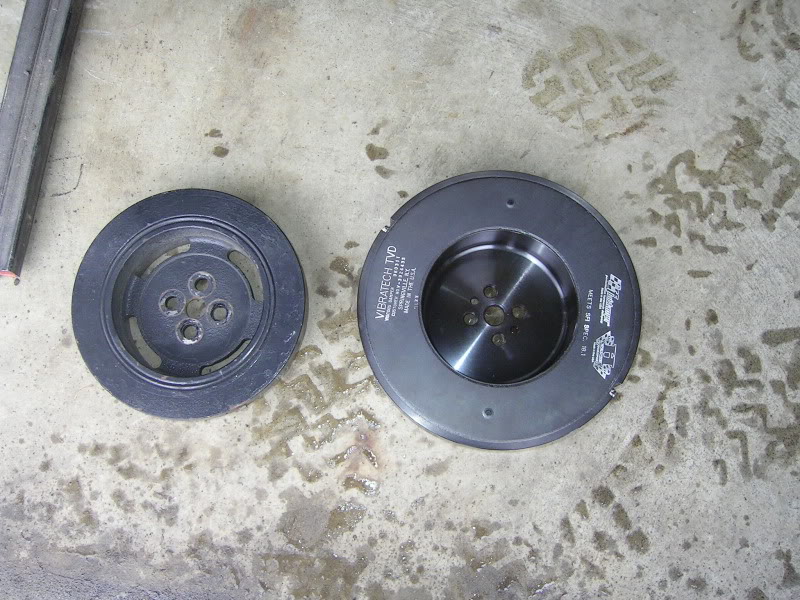

A Fluidampr is a fluid filled harmonic balancer. The theory is the fluid moves withing the balancer and will dampen vibrations and harmonic better then a rubber ring OEM style unit.
My OEM vs the new Fliudampr when I installed them....

And I guess those #12 boot-prints are for size-reference ...
Thanks for enlightening me; so that works much like a Centramatic wheel balancer.
That thing looks purely mechanical; I am guessing the electrical problems are a 1992/93 thing.
Old Sep 16, 2014 | 06:30 PM
Actually size #14 boots to be exact....
Yes work on the same basic principle as the Centramatics.
And yes it has nothing to do with the electronic control of the Alternator on 92/93 trucks.
