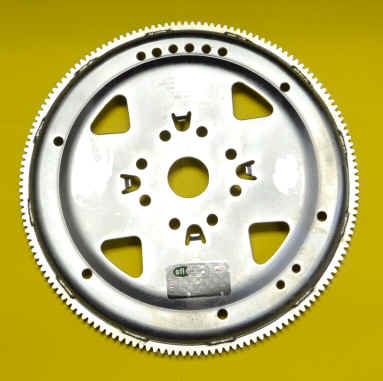

This company sell alot of parts for the dodge transmission parts. Good folks.I have a spare 2nd gen flexplate if u need one..
http://www.transmissioncenter.net/dodge.htm
#58PFP and #58PFP2. Cummins 6BT - 4BT. These Extreme Duty SFI Platinum Series Flexplates are engineered to handle extreme duty applications and designed to take the punishment of today's high horsepower engines. The 4mm thick center-plate provides a solid foundation for this new design. Ring gears are precision welded to meet SFI specifications, utilizing robotic machinery and cold-welding process. PRW Platinum Series Flexplates are engineered for excellence and are rigorously inspected throughout the manufacturing cycle to ensure that you receive the quality that they have come to expect from PRW. Rated at 800 to 900 torque if yow tow. You may need #BHS below. (Fits lock-up transmissions only.) Fits 1988 - 2007 5.9L Cummins diesel engines. Rated at 800 to 900 torque if yow tow. Cost $169.00. 2007 On 6.7L Cummins. Cost $199.00

I have the same flex plate that bigjohn92 posted. It has been in the truck for approx 4years of hard driving & drag racing. When i bought it. It was only a 125$ came with paper work stating sfi approved It has worked good for me. But I did have to make a spacer to get clearance for torque converter to front pump.
