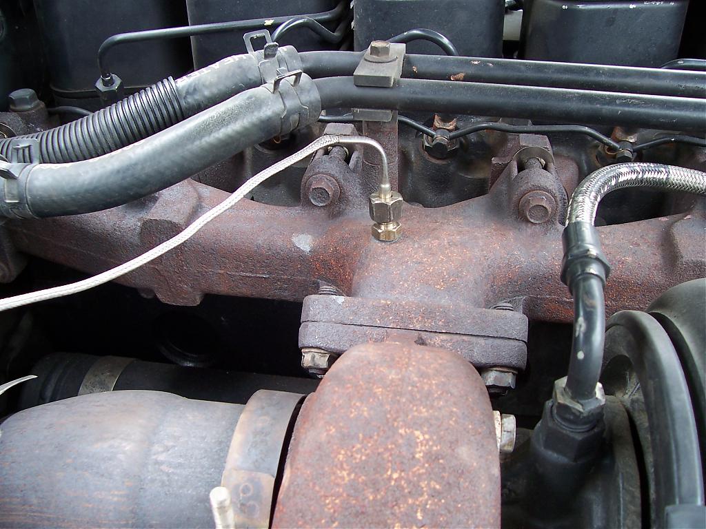

I got my pyro installed.............at last...
So at idle shes running at *300, in park at WOT she got up to 1050 before I took my foot out..
on the highway at WOT she got up to 1050 and stayed there until I took my foot out of it at 75mph..
cruising at 70 its reading 900 and goes up to 1000 up hill and down to 800 downhill..........

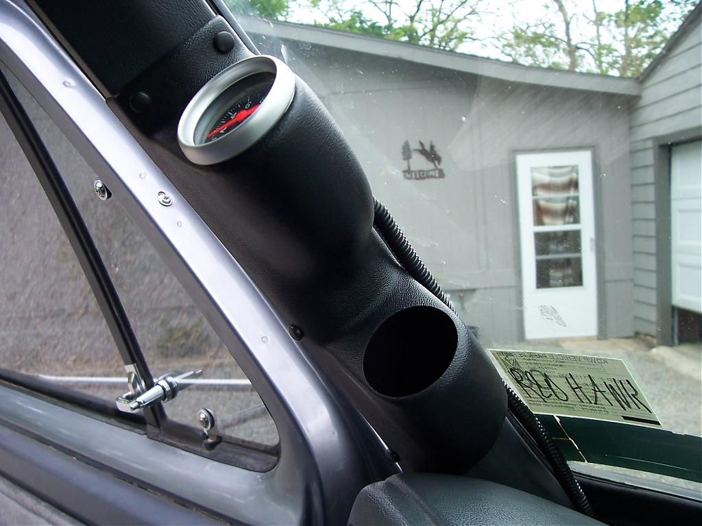

sound about right?
I left the second pod open for my future boost gauge...
being like that will remind me every time I get in the truck that I need to get it..

Sounds like you could turn it up a little.
Actually, the steady state cruise is kinda high, have you bumped the timing yet?

looks like your pillar gauges are pointing to the roof can yoe see them good

Mine are too. They did not aim the buckets very good.

No I havent, I want to get a good baseline first, then go from there. I thought the "cruise" number should have been around *700....

Nope, dont like how they set, I wish i had ordered a universal dash mount pod now.. I may change it, driving at night, the lilghts from the gauge want to pull my eyes over to it and off the road....and they are a little hard to see..

Before I settled on a pod I noticed most of the ones I saw were aiming toward the roof...........
Heres a pic to give you an idea of an alternative.....just some .5x.125 strap and a welder......

Not sure of your mods but mine cruises around 700-900* and even lower when not out on the open road. It'll idle below 300* easy, especially given time to cool down after a run. I have to be loaded up a hill to get over 1,000* I guess I drive like a grandpa though...
With my Westach duel boost/pyro guage, the boost & pyro pretty much mirror each other as I drive along.

I do think I am running a little warm.no mods to speak of except for tranny work and a BHAF..... and that would fit with my thinking the timing is retarded.
Denny thats a good set up.... but I think I will like them on teh dash better, I tend to let my eyes get pulled towards stuff up in front of me..
