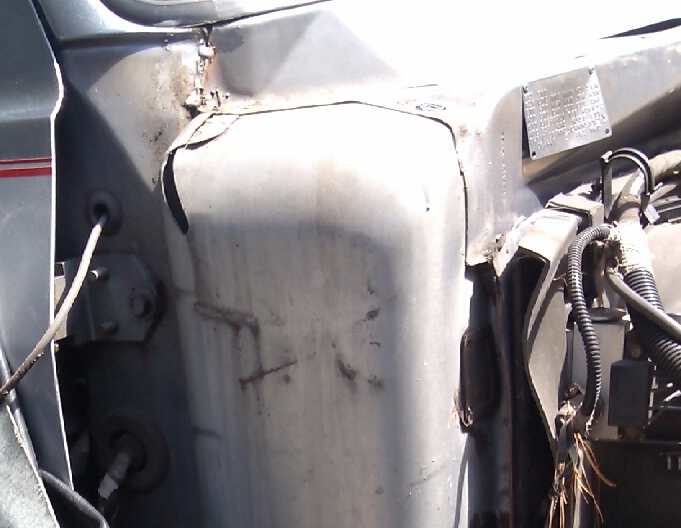

I picked a nice couple of days to do this.....
5 hours start to "finished the patch". I assume the other side will take less time now that I've done one..
The crack wasn't terrible, but still needed to be addressed, as my radio just didn't go up high enough for me to not hear it squeaking...

So I had some 16Ga metal around to do the job.... and did my preliminary bending by hammer and vise...

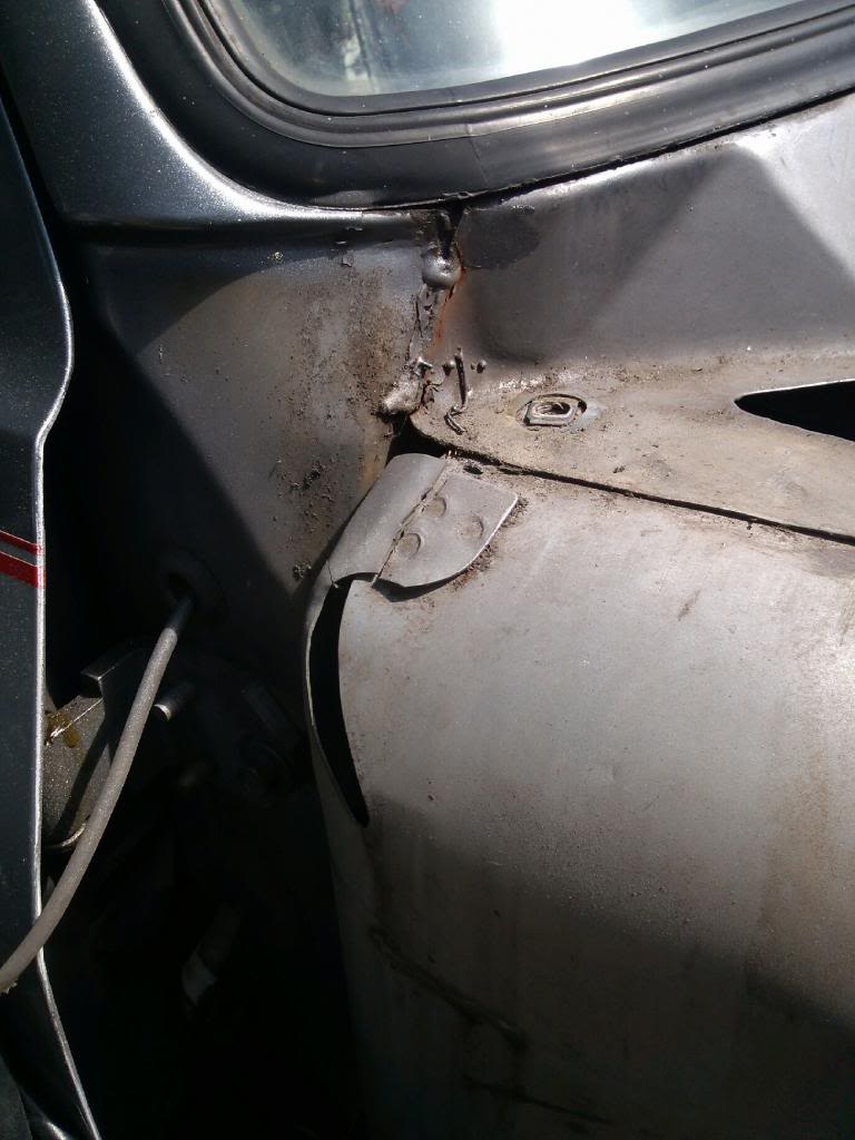

Ground off the original paint and weld..
Finished fabricating my "patch".
Installed the patch.... no I'm not a welder by trade.....

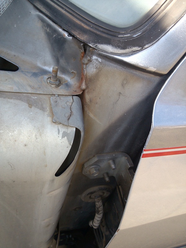

The other side was a little worse, although instead of the pieces of metal touching one another and causing that rotten noise in the cab, the metal pulled apart and continued the crack down the side as you had mentioned.
IMO the reason these things crack is also due to the "vented top" of the box that allows it to flex much more than if it wasn't vented. When I closed up the top of the box, it became much more rigid. Let's hope I'm right and I haven't caused more problems than before.
I used a cold galvanization spray on the inner panels as well as a "rubber sealant" on the patch and the cab bottom below.
