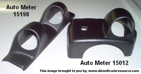

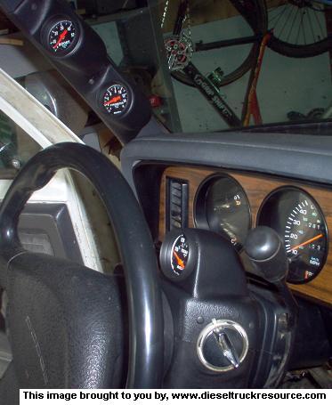

Originally Posted by woodrat
does that 2nd gen column mount fit our trucks??
Yes - but its designed for 2 1/16 gauges..
https://www.dieseltruckresource.com/...4&postcount=18
