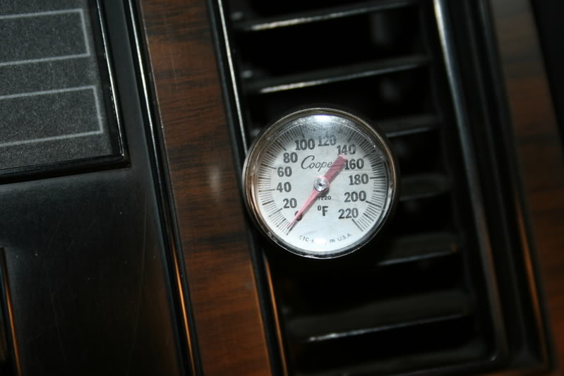

Virgin R-12 baby my AC gets so cold that we wear a jacket in the cab in the middle of summer.
For around town low temps I have 2) 2500CFM electric fans providing ram air through my condenser, and incase you were going to ask, my evaporator has only iced up on my maybe 4 of 5 times when it is this cold.
My wife and daughter are always complaining and saying its too cold in here especially on long trips, so I usually temper the air up to about 35* - 40* with the heater to make it comfortable with a light jacket. Also the cold air blowing on my knuckles makes them stiff and hurt sometimes but it sure keeps my cold drink frosty.
I would question that R-134 works as good as R-12 or is more efficient but maybe someone else has had better results that I have, I think ICOR works superior to R-134, even stationary appliances like water chillers or window boxes I have seen lower temps with R-12 than newer R-134 but again this is just my observation.

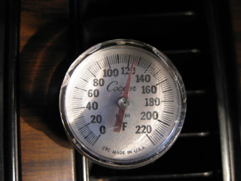

Oh and just incase you were wondering, this is how hot my heater gets, nice and toasty.
