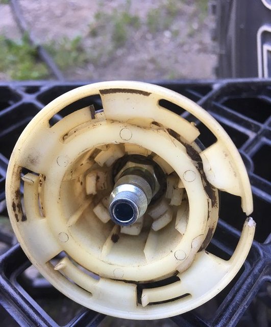

I used an old fuel cap and drilled it out and threaded a male air fitting into it put about 10 lbs of air on it let it sit for 10 or so minutes followed the lines presto leak where PO had spliced the line together fixed that has been fine ever since
