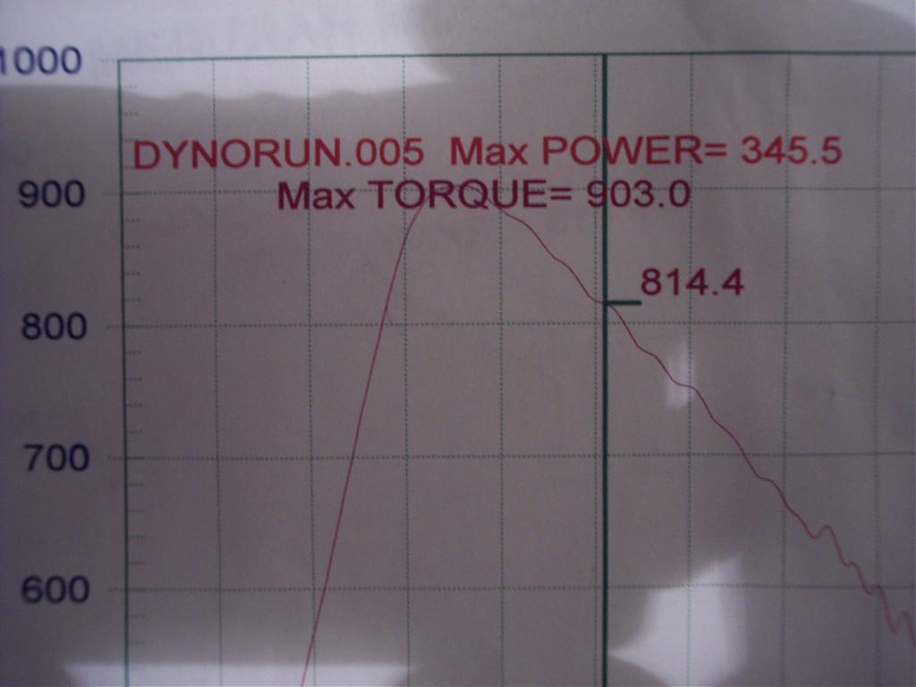

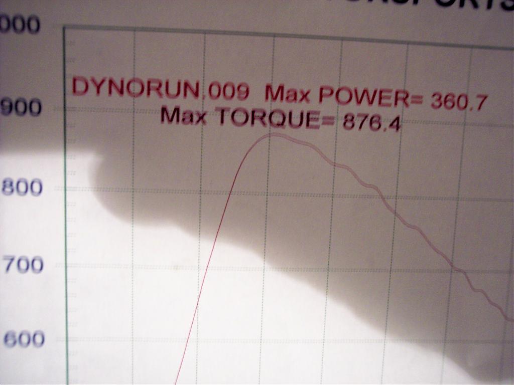

put my truck on the dyno today, Very happy was looking for 325HP first run was 345hp/903tq then advanced the timing a bit more and turned up the screw a 1/4 turn and got 360/876.up from my last one at 280/704.

Wow, those are amazing numbers for what you have in your sig!

Wow im really impressed for your mods! I think its time I get the Stage 4 compressor and a fuel pin!

I installed some pods and a 4000 gov spring last weekend. thats when i really noticed some improvement. i was able to back off the fuel screw and still had more power than before. I will update my sig.

What kind of dyno? What did the pyro say? Boost #'s? is that hx-35 stock?
Definitely some impressive #'s--I know I'm jealous

DYNOJET, 36 lbs of boost, pyro got up too 1100, turbo is stock i did a little work on the inlet of the compressor housing

Those are really big numbers for an HX35/12 at 36psi and only 1100*.
Is your fuel screw maxed yet?

The screw was maxed on the last run i said 1100 deg but wasnt paying close attention.
