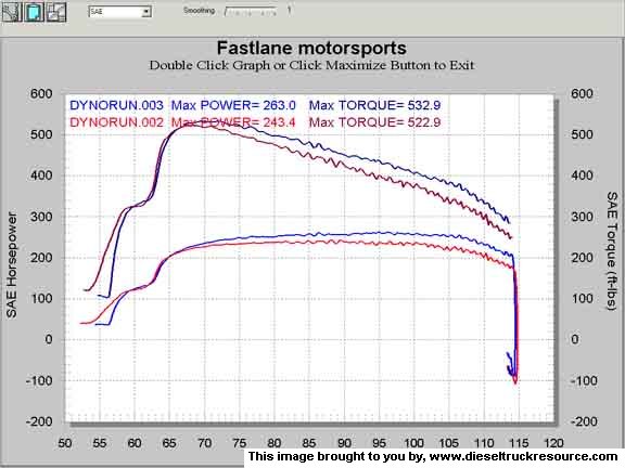

Well I've finally gotten an "Everything's Working" dyno run completed.
Today's run presents with:
243HP/522ft/lb on straight #2 (Red Curve)
263HP/532ft/lb with water/methanol (50/50) (Blue Curve)
It's interesting how the W/M gain improves as the RPMs go up.
I actually had a run with 266HP but the torque was down by 10 or so ft/lbs.
I'm happy with it considering it's pretty tame fuel-wise compared to most.
This was on a DynoJet 238 at http://www.fastlanemotorsports.us/ (72*F, 6%RH, Barro 29.71", Dew point 1*F), SAE corrected.

You're not spraying enough water/meth. Usually guys with enough air see more of a gain than that.
I think with a good TC in there you could get 'er in the 280's. And it would be really fun to drive.
Well I just re-plumbed the W/M system from the pump to the nozzles replacing 22' of 1/4" OD tubing with at least two compression type fittings that use the inserts in the plastic tubing (very small ID). It's now one single piece of 1/4" ID tubing.
I've also removed the check-valve completely for now as I can't seem to make it drain on its own. Out to lunch there.
It accelerates MUCH harder now!
Still can't seem to bog it at 15psig boost on up.
Old Feb 24, 2007 | 11:50 PM
wannadiesel's Avatar
Posts: 22,594
From: New Holland, PA
If you can't bog it at full pressure your system is too small.
The water/meth is good for 40 HP when set up right.
