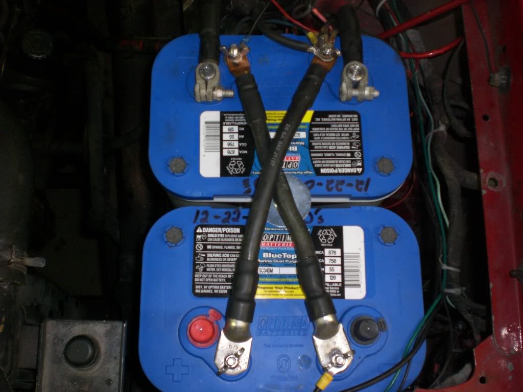

Yeah, that is why I will probably buy 2 new ends, shorten the wires, and turn the front battery around.
Jim: That is some impressive knowledge. Is it bad that I am just running the two batteries direct like shown in my picture?
Unfortunately, as of yet, I haven't driven the truck more than a mile since the install, but later this week I will tell you guys what I think. I gotta get my 4X4 fixed between now and then. lol
Thank you,
No there is no problem at all connecting 2 or more batteries in parallel as long as they are the same age, same CCA, RA and of the same type meaning do not parallel a Starting battery with a Deep Cycle battery.
GM diesels have a battery on each fender connected in parallel as well as the newer dodges.
Also class-8 trucks and heavy equipment routinely will use 4 or 8 6-volt batteries connected in a series/ parallel arrangement to gain more amperage.
The down side to this is if one battery goes bad it can affect the entire system unless you have a way to disconnect them, a simple 100-amp solenoid could be added to your setup to give you the safety and also an onboard jumper battery.
I have had one battery in a parallel arrangement have a shorted cell and become a 10 volt battery while it was connected to the other 12-volt battery, the results were a hot smoking battery that was going to explode at any moment.
When I worked on Transit Coaches we were always having melted or exploded batteries because they would only replace 1 of the 2 or 4 batteries in the tray, shorted 8-D batteries are not what you want to have to be next to while you are trying to disconnect them.
Also I would turn one of the batteries around so you could keep the interconnection cables from crossing each other, I understand why that you did it this way but I would do it just because it looks confusing, although you know how they are connected and I know how they are connected not everybody in the world is that smart, there is a good possibility somebody could connect them (+) to (-) and (-) to (+) and have a small explosion resulting in molten lead.
You could turn the front battery around and then reconnect the interconnecting cables by bending them into a semicircle (C) shape and have them each loop around your mounting bolt from opposite directions, I would also use some RED shrink tubing on the POS end of the cables.
Do you know that you have a Positive lug on the Negative terminal?
Other that that, your setup looks geat.
Jim

Posts: 2,081
From: Wisconsin
Thanks Jim. Yes that Lug was a goof on both my mechanic and myself. He sold me two positive lugs, and I put them both on my truck. I honestly didn't know there was a difference. lol I do plan on turning the front battery around because the wires cross and one rubs on the nut that holds the whole thing down. (at least it's the negative one) I also thought that it looked confusing, and that if someone hooked up a set of cables wrong there could be a very bad accident. I will try to get some new ends and some shrink tube this week. Should I worry about the two batteries hooked up this way? I already have about $420 stuck into this whole thing. lol
