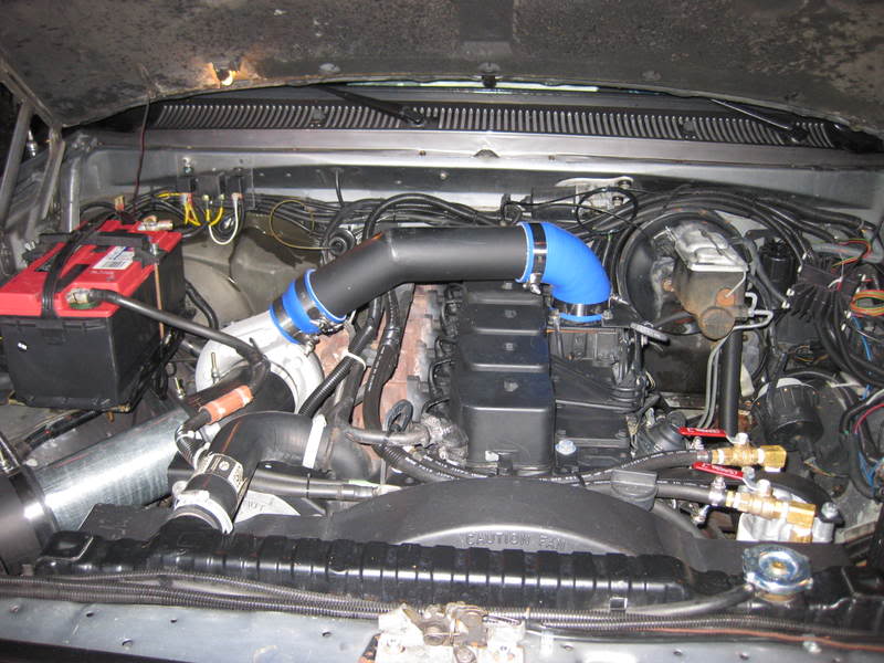

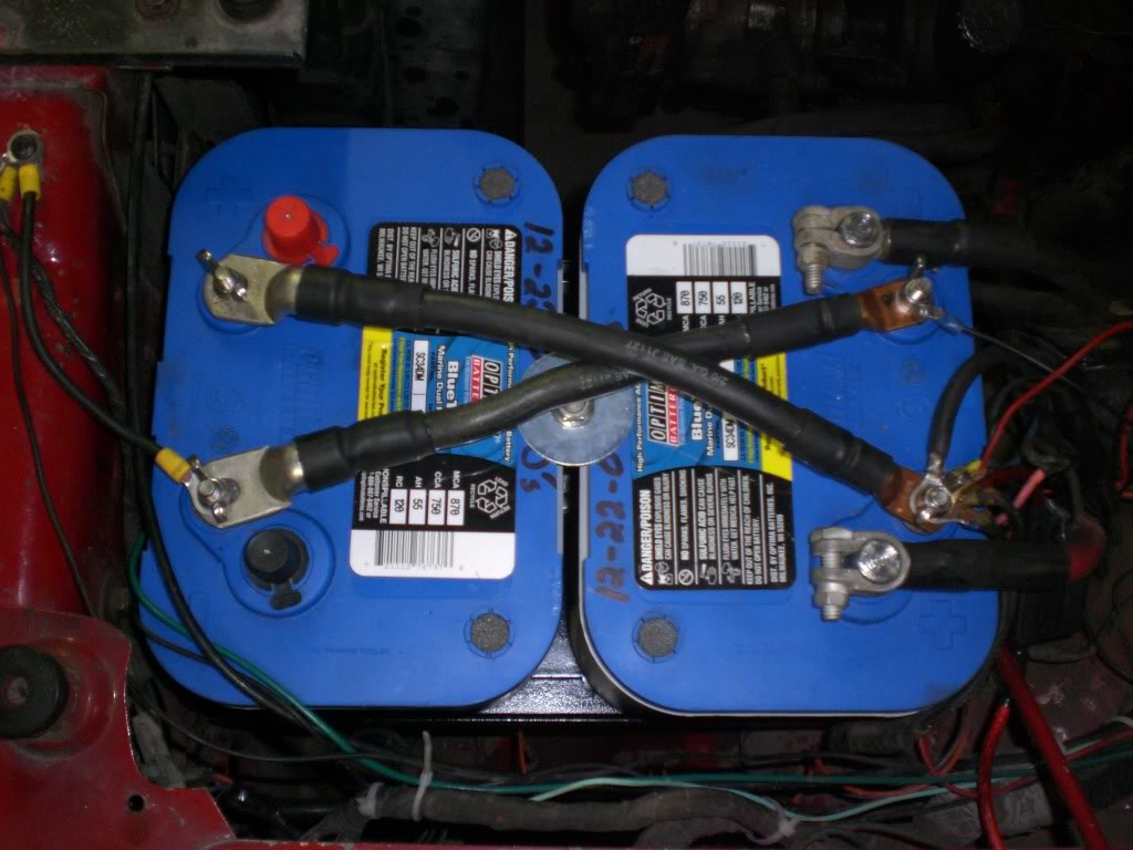

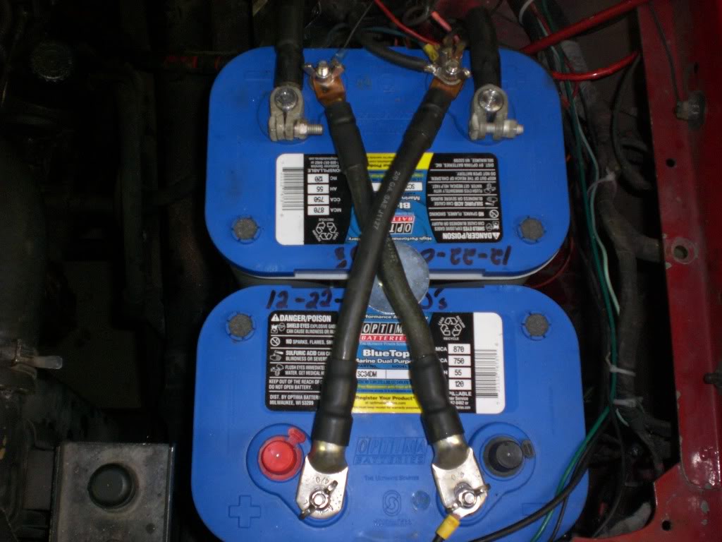

So I got a pair of Blue Top 750 CCA 12V Optimas. I wasn't looking for CCA as much as I was looking for reserve. Total cost of install: $420 From the pics it looks like they are wired in series, but they are, infact, wired parallel. One of them is in there backwards because The cables I had were too long. Might get around to buying different ends to shorten them one of these days...

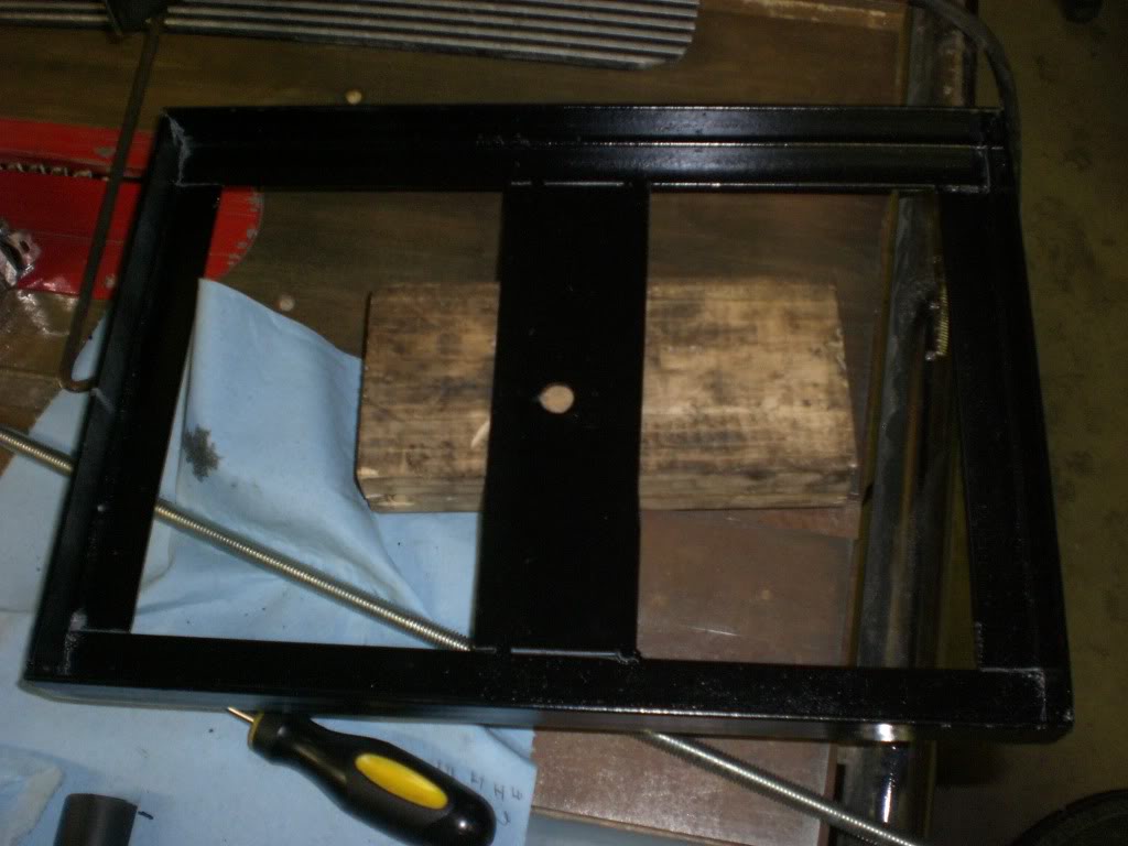

Made Bracket for bottom like so:
Hole in center bolts to hole already in center of battery tray:

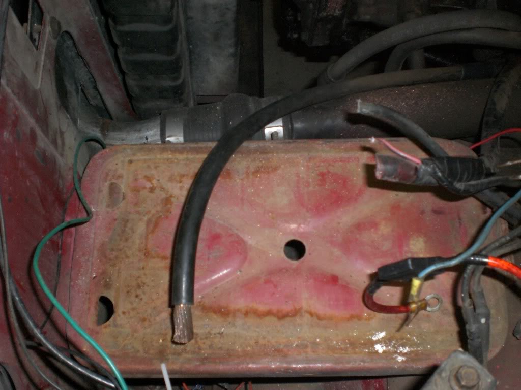

3/8 Threaded rod goes through both holes with a nut on bottom and top, and another nut with a 2" washer on top of the batteries:
Just got em in last night, so I really haven't had a chance to use them yet, but I will post my thoughts about them. What y'all think?

Looks good. Might want to build a better bracket for the top though just in case things get a little rough going down the road.
If you built that lower bracket you could do something better for the top.

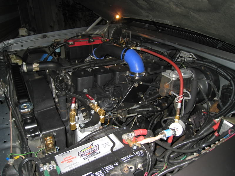

This is where I installed my #2 auxiliary battery; I also have a #3 battery that is an 8-D diesel truck battery located in the bed behind the driver’s side wheel well.
They are all interconnected using Sure Power #1314 Battery Separators I replaced the 100-amp solenoids with 200-amp solenoids for more capacity, the Separator for the #2 battery you can see on the drivers side inner fender in the far right side of the picture, it has the red shrink tubing over the ends of the #2 welding cables.
I welded a bracket using some 1” square tubing from the inner fender and braced it to the frame rail; on top I bolted a standard battery tray.
Here you can also see my 160-amp alternator.

Why a separator, it is better than an isolator because it will only charge the primary battery until it reaches 13.2 volts and then it will pull in the solenoid and charge the auxiliary battery, then when the input voltage drops to 12.7 volts like when the engine is turned off, the solenoid will disconnect and isolate the auxiliary battery from the main battery this way if you happen to leave your lights on and run your truck battery dead the auxiliary battery will remain fully charged.
With this particular separator it has a built in assist feature where you can press a button in your cab and you can parallel the 2 batteries and then start your truck, like built in jumper cables without ever opening your hood. Or you can wire this into your ignition switch “start” position and automatically use 2 batteries every time you start.
I have mine set up on all 3 of my batteries so I can spin my starter with almost 4000-amperes if needed.
