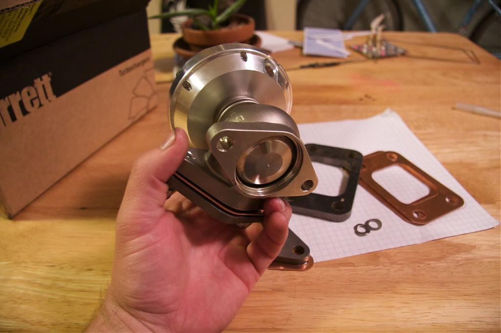

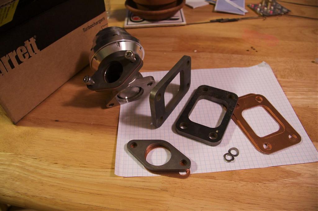

Wish I could say that I have gotten more done, but Im waiting to get my cold pipe back from the powder coaters. After a lengthy discussion with Fred Swanson I decided to run an external wastegate. Im choosing this option because it should be a little more tuner friendly...but more fabrication. I had some flanges cut, as well as copper gaskets to make a spacer to go between the manifold and turbo...should be fun! Man, I have to say that the Tial 38mm wastegate is a lot bigger than I expected. Its a sweet product though.

Old Apr 25, 2008 | 12:08 AM
  #39
Alwaysworking's Avatar
alwaysonDTR
Posts: 2,551
From: Keizer, oregon
did those just come today? if so was it like christmas?
everytime i order parts thats how it seams.

Are you gunna let that external gate dump into the atmosphere or are you going to plumb it back into the exhaust??
It sure would sound good with a small pipe off of the gate straight down to the ground!!!
Old Apr 25, 2008 | 11:37 AM
  #42
MikeThomas's Avatar
Posts: 919
Likes: 6
From: Seatac WA
Im going to plumb it back into the exhaust...I need all I can to spin that bht3b.

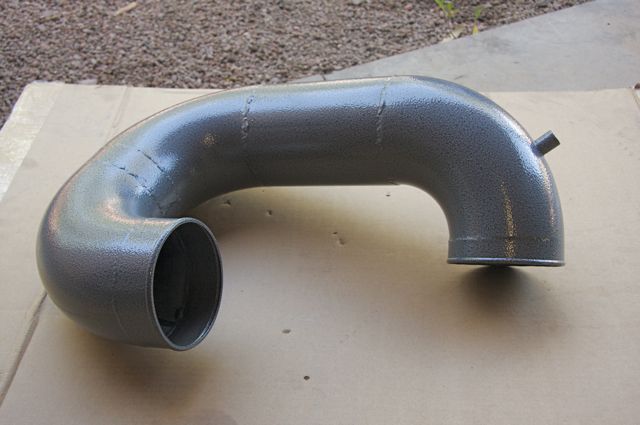

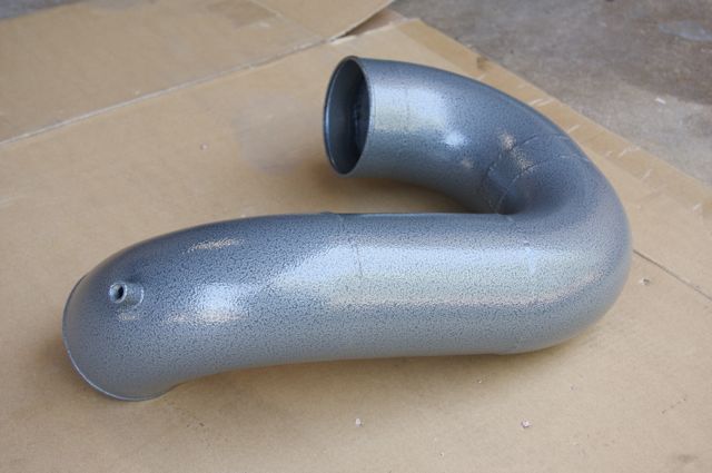

Ahhhhh, finally back from powdercoating. Now I can get back to work.
Sweeeeet!!!!!!!!!!!!!!!
