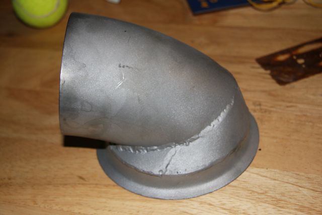

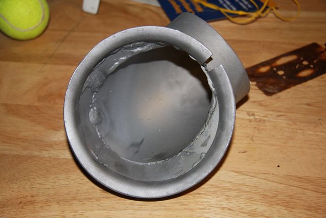

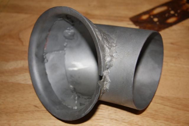

Dang its ugly, but at least I wont have to cut myfire wall.

i bet if you leave it that long it will sound cool.

hahahahahahaha!

The downpipe/firewall clearance is one of the biggest pains in building turbos for a first gen! Mine is so tight (even after cutting) that it will rattle when I'm on the throttle in reverse.
Yea, if you like bleeding out your ears!

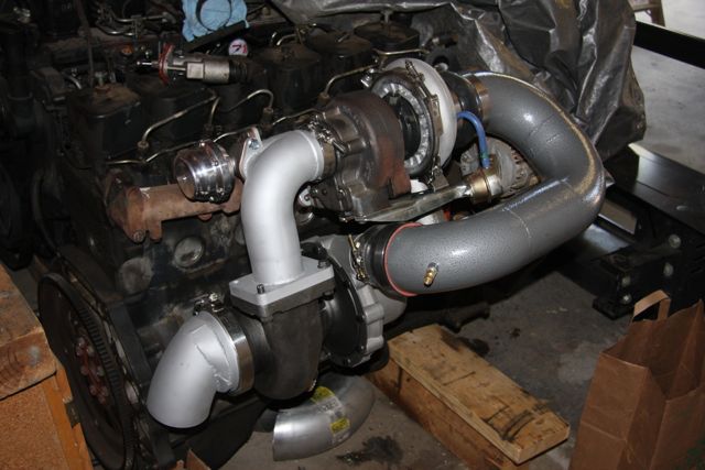

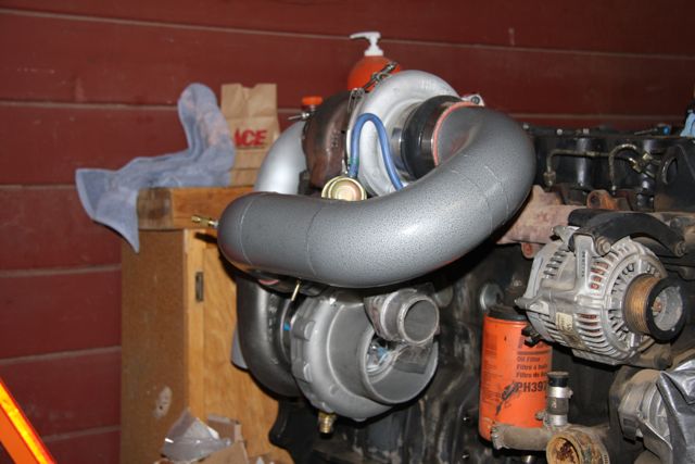

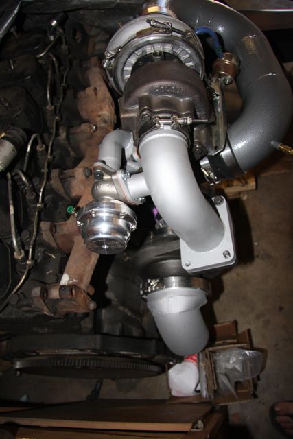

Well this is one of the final mockups. Ive got the wastegate plumbed in, kinda tight but I think it will work. Now to collect all of the last minute bits in pieces before it goes in.

look good, how close is it to the engine mount?

The engine mount isnt going to be a factor, the mount itself falls below and forward 6" the twin setup. My main concern is if the 45 degree rubber intake adapter will clear the oil filter. I need to order it I guess.

get a bypass oil setup like amsoil and mount it were the old intake was at it makes a huge difference in changing filters and room for the primary.

Nice looking setup.That's the drawback to the 3b. It is long and heavy. One of the smaller S400's can be held in place with 1 hand and is short enough to clear the firewall without mods. Save money on the turbo, spend extra time on the install. It's one of those things that makes you glad you did it yourself, but happy it's over.
