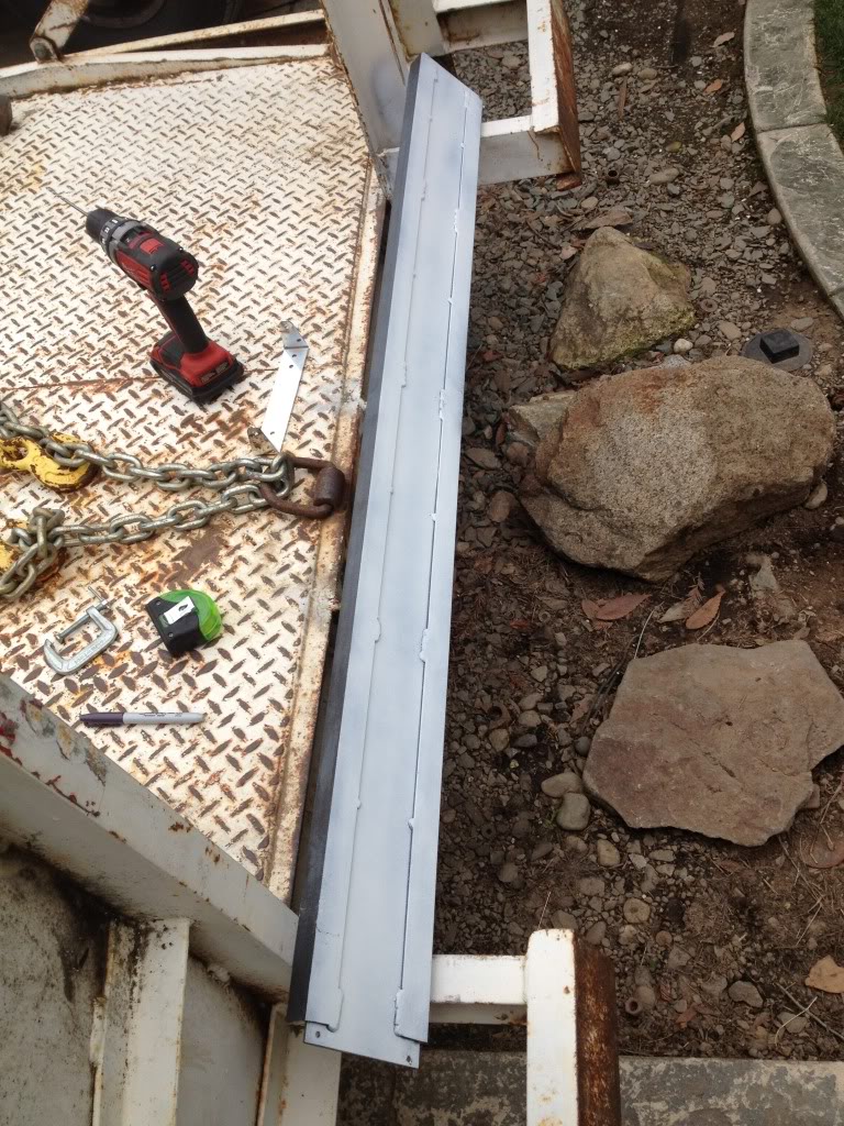

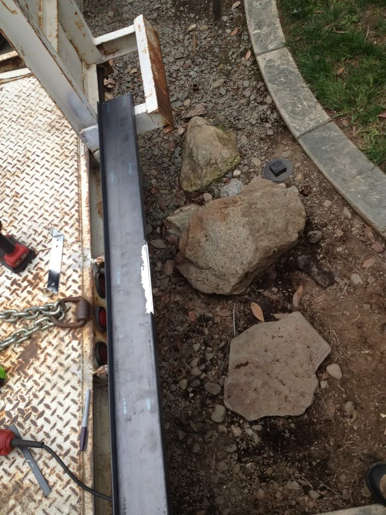

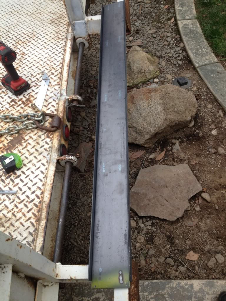

I had removed the "shelf-it" aluminum shelf from the old 93 and planned to use it in my '92 W350 with COBRA LTD29BT CB radio.
The CB wouldn't quite fit the stock shelf it unit - so I trimmed it but it left an already FLEXY shelf ready to bend under s slight breeze.
So using the original Shelf it mounting tabs I fabbed up a shelf out of STEEL
Parts needed:
50" long:
(1) 1/8" x 4" plate
(2) 1x1 1/8" angle
(1) 1/8" x 2" plate (optional)
I tacked all the pieces together. The 2" plate is just to give it a flush look when you cover it with headliner material. I used 3M super trim adhesive and the headliner material from JOANN. (matches my newly installed headliner)
on to the pics:

clearanced front of the angle for CB (still plenty stiff and won't bounce)

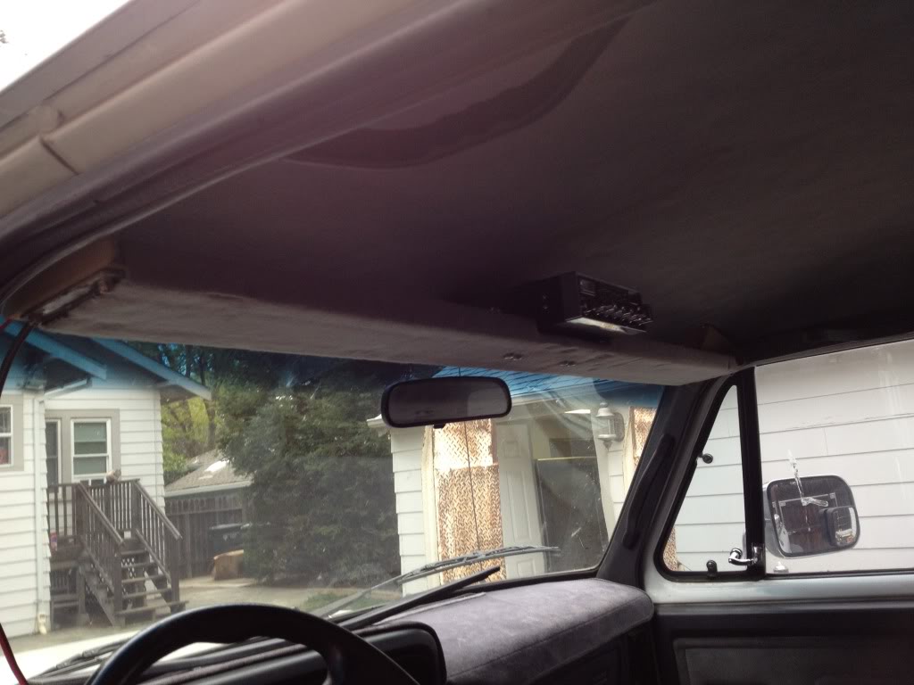

Not perfect on the headliner application - got a little too heavy in spots with the adhesive and it soaked through.
But now it is super solid and will do the job!

how did you bolt it up there? looks real nice though. i like that passenger handle dealio too

I used the original "Shelf-It" mounting brackets and just bolted it to those.
Yeah it has handles and steps. The PO was an older gentleman in his 80's and like to have a lot of hand holds.

do the "shelf it" brackets drill right into the cab roof? or do they go into the visor holes? im kinda thinkin about doin this honestly

They tap right into the visor holes. The original Shelf-it unit had provisions for the visors under the shelf but I found that it was way too low. Plus I am an avid sungazer so the sun doesn't bother me when it is down on the horizon when driving any way. I don't need the visors.
