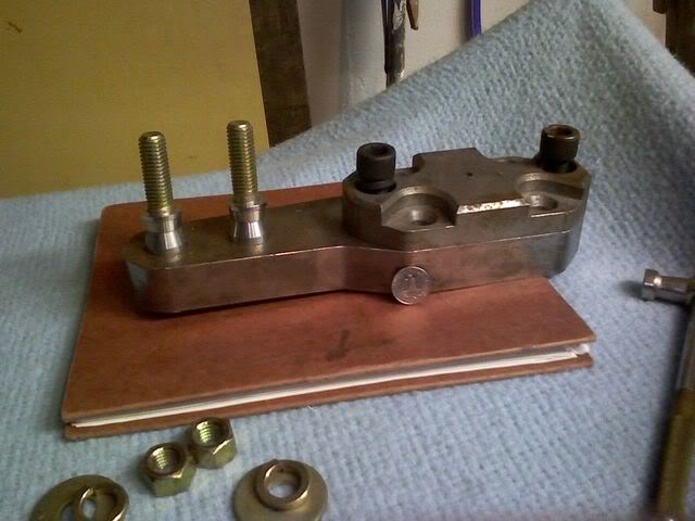

D60 X-Over how to @ RCC
I used parts from Blue Torch Fab
If your gonna tear into your axle rebuild your kingpins, change your u-Joints while your in there
