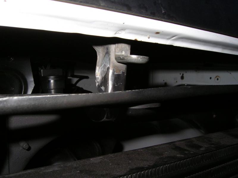

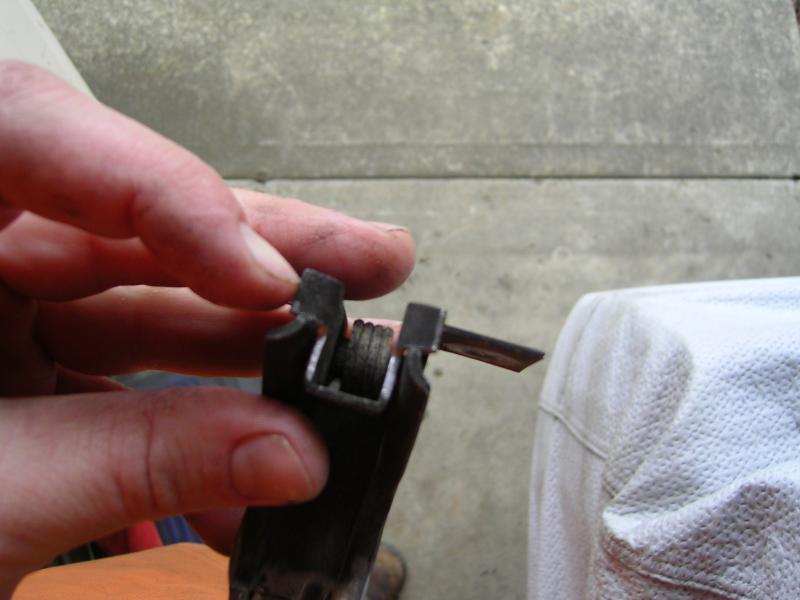

I then had to spend a couple hours carefully modifying the hood catch. I had to cut out about 3/4" I guess. But through it all I had to carefully alter things to clear.

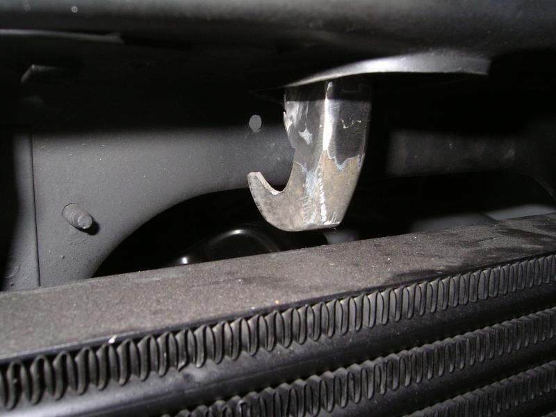

I also filed down the tabs at the back. This allowed the hook to roll inwards a bit more towards the rad support, and give it a little extra help in clearing.

I would be more specific on what I did...but this all depends on how you go about installing your PS IC. Some people have not had to alter the hood catch, many do have to alter theirs.
