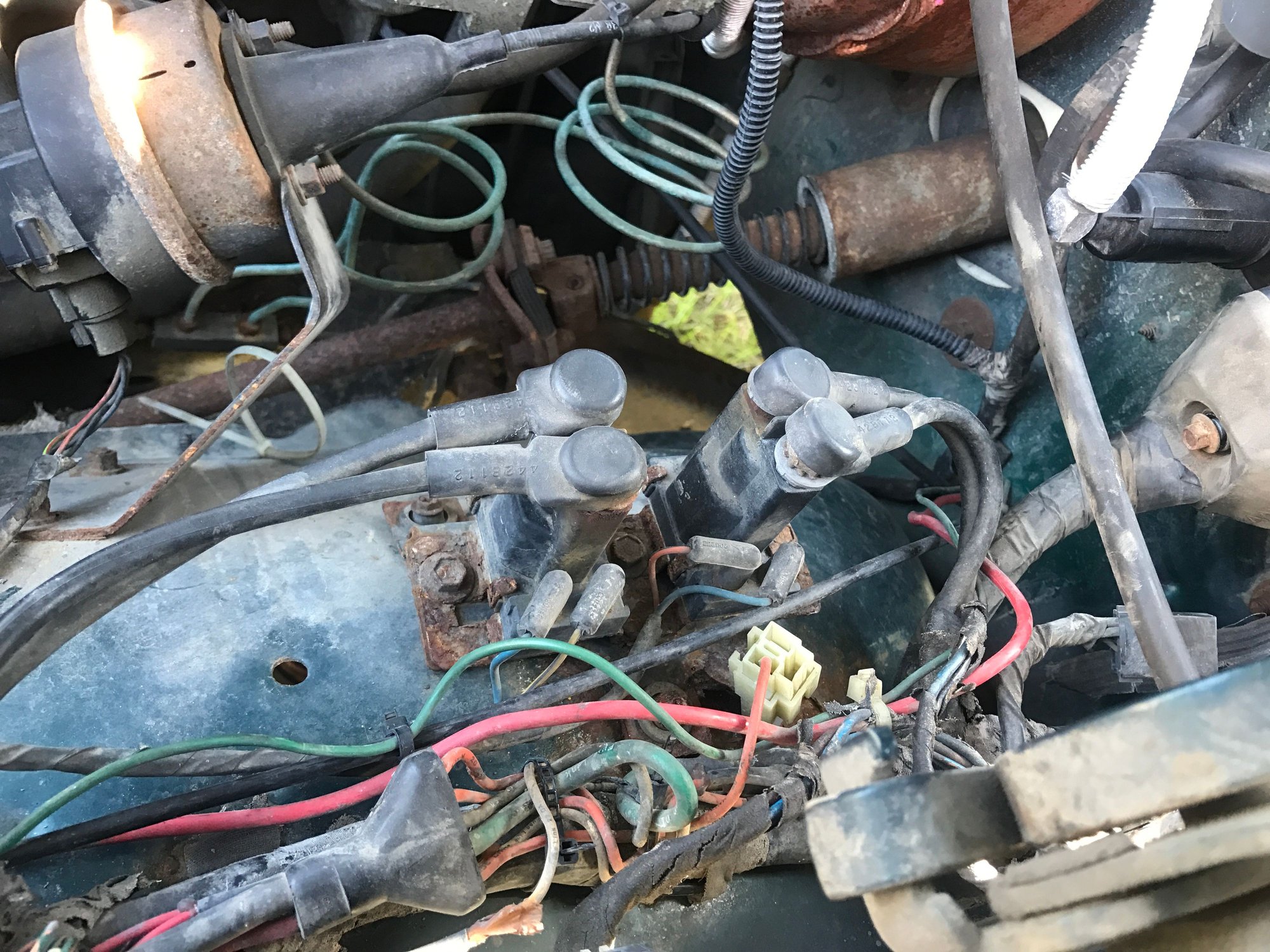

Also, ehat are these 2 canister things with the 2 wires coming off each?

well the wire has been gine ever since i can remember, and all this just started a few weeks ago. What are thise cannister things in the pic i posted?

okay im gonna ground that out. Do you know what those things are in the picture
I think that those are for the grid heater, but I am not completly sure...Mark

Posts: 7,277
Likes: 2,884
Yes those are the grid heater solenoids.
