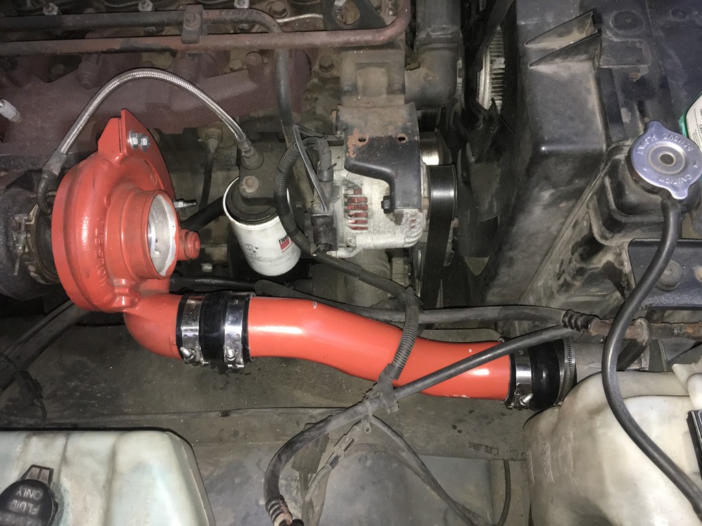

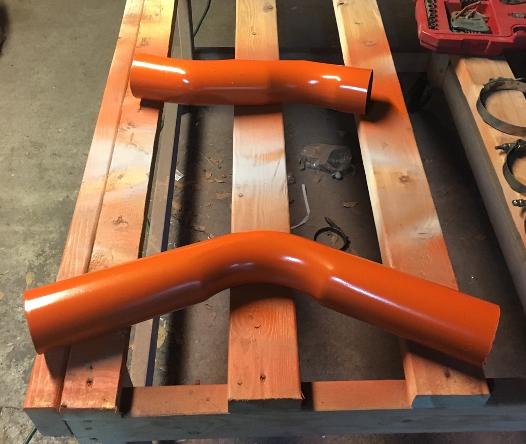

i think he stopped making them. a good alternative is to use a 24v intake horn, which has a 3" inlet and then just get some 3" pipes bent at an exhaust shop
