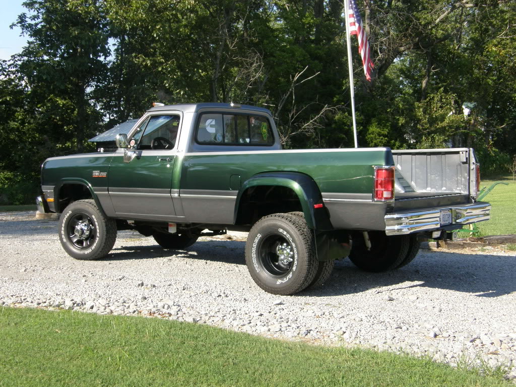

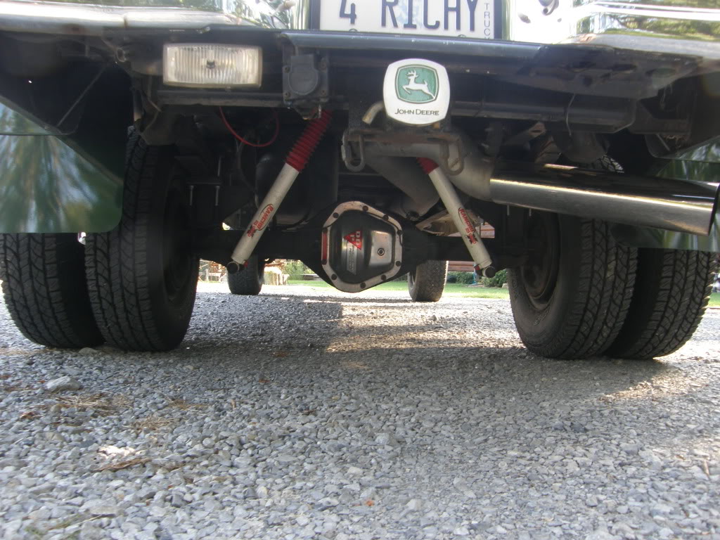

Jim i was thinking that a SRW was even narrower than a cab chassy rearend.
i put 2 inch spacers on my truck and it looks about your pics.
this is the only pic i have from the rear, if you need a better one i will get one.
mine could use another 1 1/2 - 2 inches on both sides to make it look like a factory dually.

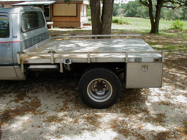

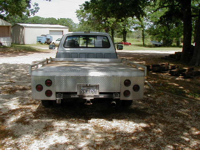

Here are some pics of this done to a '92 d250. I have done this to a '90. '91, '92, and a '93 4x4. Still have the front hubs for the 4x4 if someone needs them. The only thing necessary is to drill the hubs for the bigger studs and they will bolt right on. No spacers needed really, it will be cab and chassis width. Especially if you build youe flat bed like I do, you will appreciate the small bit of difference. Also if you want to use the stock bed they look fine with just off road fender flares. Here is a pic of the same treatment on a '98, but it was a little more work. Moved the backing plates inward for the deep D350 drums. These years have bigger O.D. drums so had to use the D350 drums. Some of the pics are in the following links.
https://www.dieseltruckresource.com/...d.php?t=288796 the https://www.dieseltruckresource.com/...d.php?t=295641
Attached Thumbnails Converting my 250 into a Dually.-p4281062.jpg   Converting my 250 into a Dually.-p4281063.jpg
