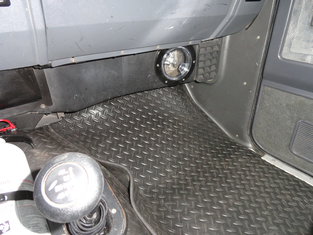

I was crusing past West Marine today (before I saw Carmutts post) and stopped in.
My hole saw was just a hair too small, but with my dremmel, it was no sweat.
Good thing I didn't need to do this....
I like the clear cap, as I'm easily alerted to more crap entering my heater well. You wouldn't believe how much stuff was in there. I'm actually getting better fuel mileage because of all the excess weight I removed..... and my heater door actually closes now !
Can't say thanks enough for such a great idea. When I see stinkbugs crawling around in there, I can just laugh as they perish..... and stink up my truck !
T.

Great idea...parts arrived Monday and 30 minutes later I vacuumed out a good amount of leaves, dust, dirt and lint. Definitely has improved my heat situation.

where did you get those floor mats?

Jaybird, where did you get the Ram emblem? Thanks, Mike
They're not originally truck floor mats... They're comfort floor mats from Homedeepblow, in their flooring section. I used 3 or 4 of them to fit my floor, as I'm not a fan of carpet in any way shape or form.
They work great, really thick (noise reduction) and when you need to you can individually remove each side to clean underneath or let the water out.....

Ram emblem
Santaclaus I got the ram head from the center Of the center caps I put on my truck. It was the center I cut out for the front hubs.

Great job! I didn't know Beckson made black ports!

That's the best idea I've seen for closing and dressing the hole, big thumbs up!
