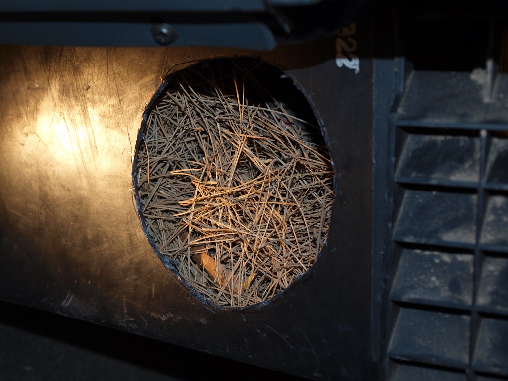

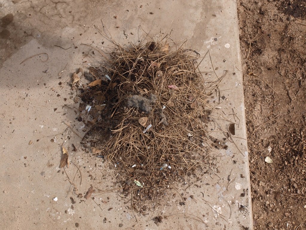

Well, to be honest, I didn't really think that I needed to cut my ac plenum box, after all I live in AZ and nothing bad happens here. My jaw hit the ground when I got it open. If you live anywhere near a pine tree, you need to check too. Between the pine needles and the dust, the coils were probably 70-80% blocked. The air volume feels nearly double. I cut mine with a dry wall knife, came out pretty good...Mark

Holy crap dude!! I plan on cleaning mine out as soon as I get back from offshore.
Dang and I thought mine was bad coming from SC.......
Please tell me you used that to light the fire in the chiminea tonight ?
Pine needles are highly flammable and would be an excellent fire starter...

You got me T, I was freezing my tail off in the 113 we had today, so I used the traditional bow method to start a fire that I learned on Survivorman. Saved my life that dry tinder. I was also afraid that the needles might ignite my 100% anti-freeze. It's rough out here in the wilderness..Mark
