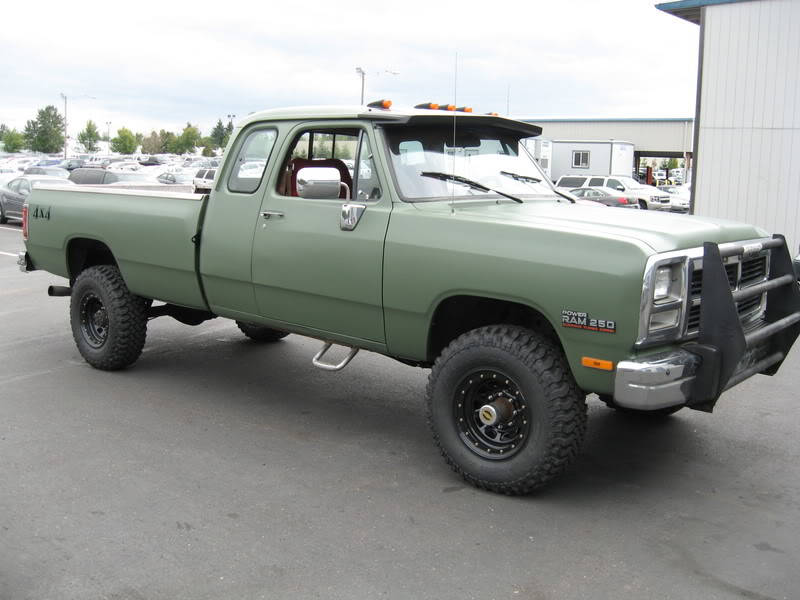

oh she's a 1992 intercooled W250 xcab 4x4 5spd....

P.S.: I like the colour of your truck. Body work looks real nice.

wow, that is a beautiful truck!!
