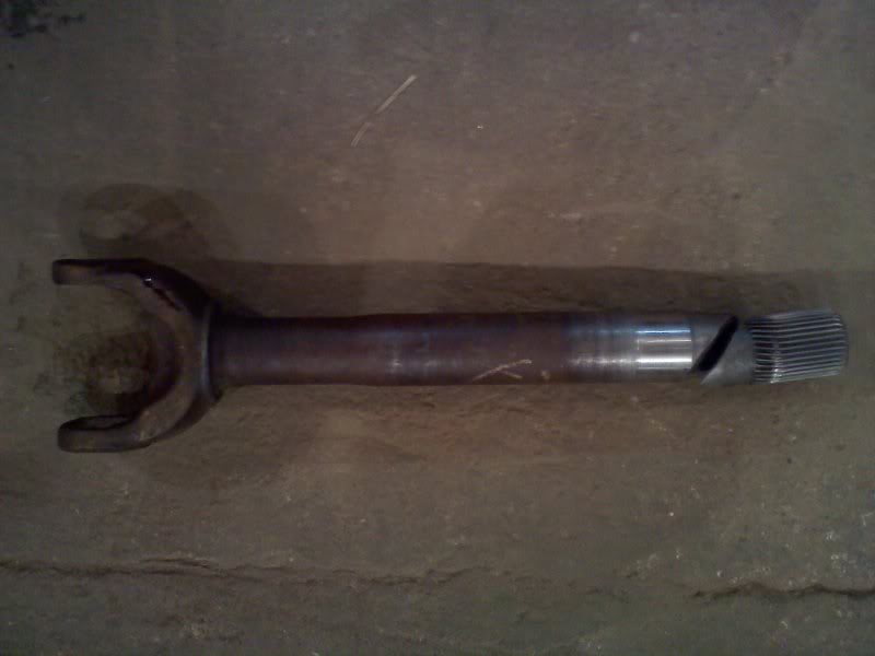

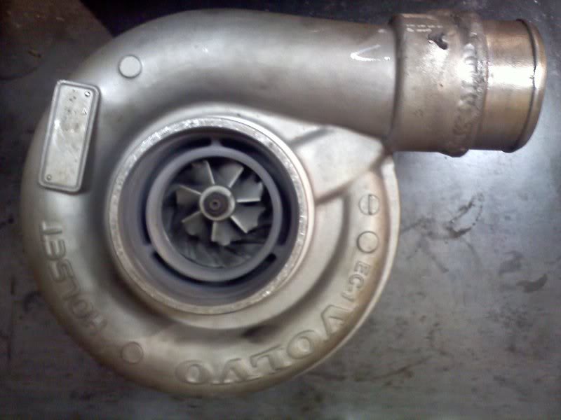

Here is what let go on the puller this year, in order:
HX52, snapped shaft.

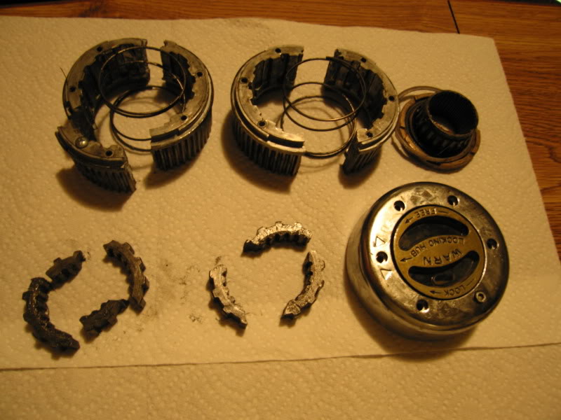

Warn premium 35 spline lockouts, exploded.
Stock 35 spline inner, twisted off.

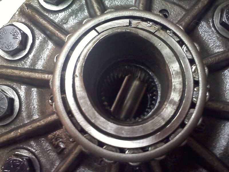

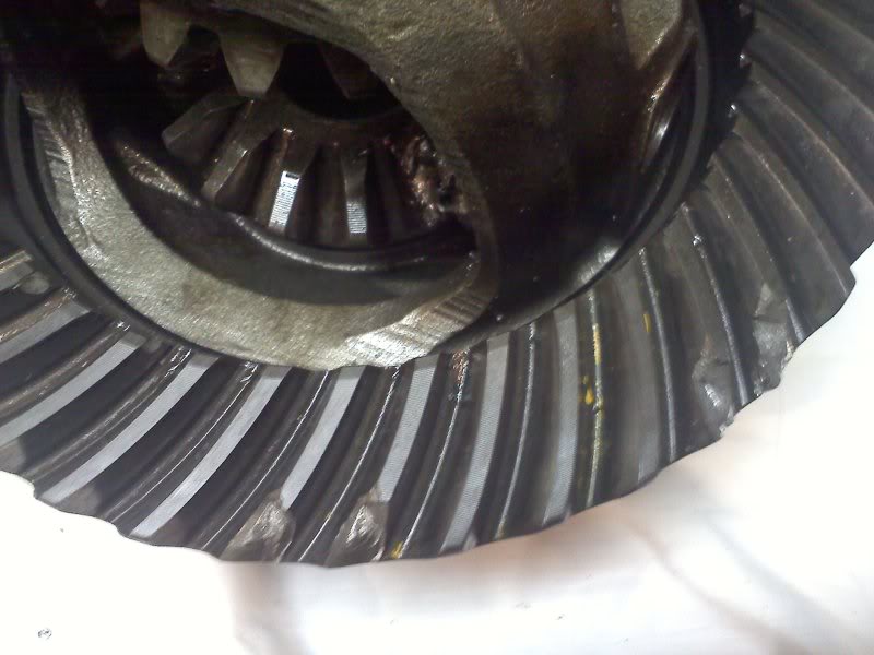

With all the binding and hammering, this also messed up the carrier and ring gear. Had to cut the bearings apart to get the carrier out. Welded spiders held up though.

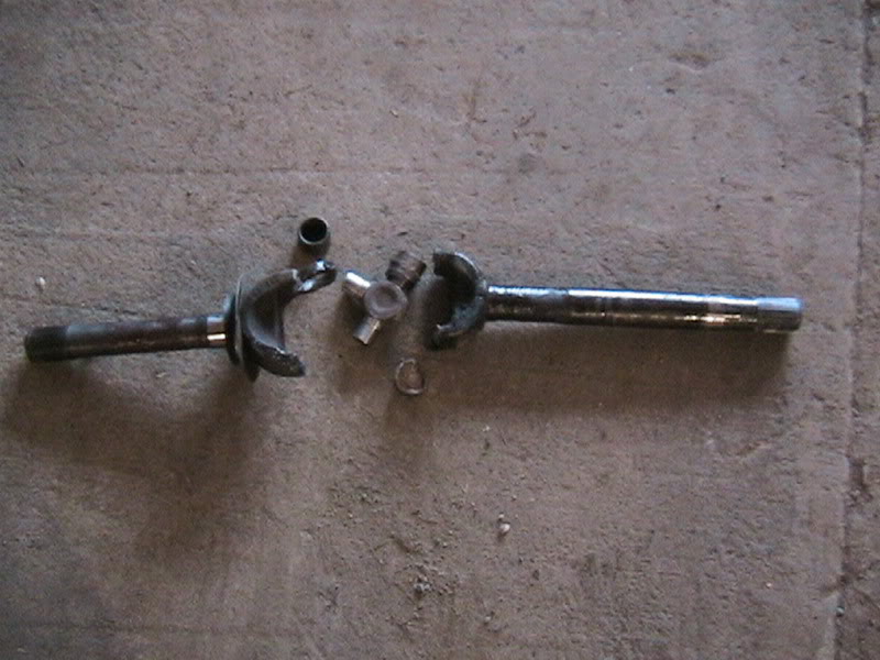

Cold forged Spicer wheel joint, took out both axles.

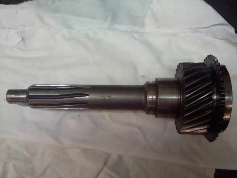

Somewhere in there we twisted the input on the Getrag too.

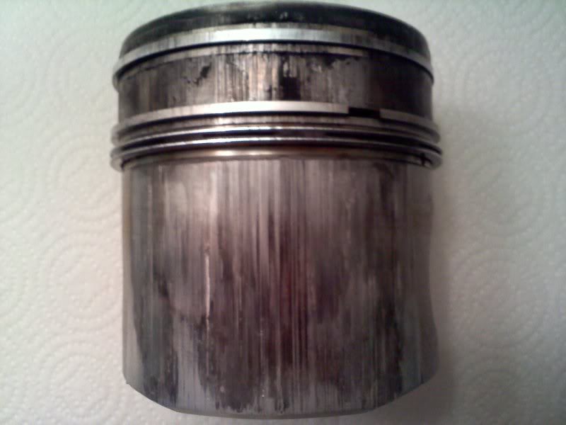

And burned a piston.

I think thats it.

What timing were you running to burn that piston? or did that melt down from other problems?

One question though, I thought you were running a N/IC shortblock. I see an IC piston????
That motor is out of the '96, it went in the puller this year. The 89's mill is now resides where this one came from...

Timing was set @ 30*. The #6 piston was the only one melted a little on top. 4 of the holes were scuffing, but none as bad as #6. I am pretty sure it was from getting it too hot for the piston the wall clearance we had. Hard to beleive 300,000 miles wasn't enough to loosen it up.
