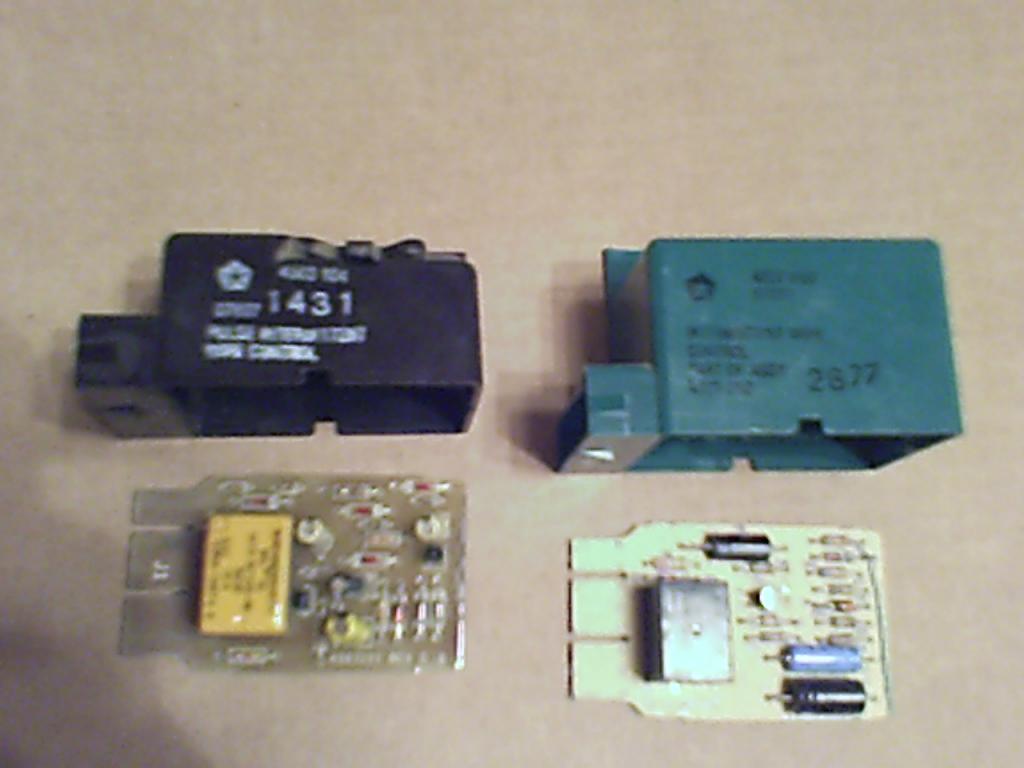

can I use this wiper module?
Found the green one in a 90sumthin new yorker in the junkyard today. will it work?
Old Mar 28, 2011 | 01:42 AM
I removed the, skipping and irregular cycling, black one that was in my 89 wiring, and installed a green one like you have there....since I already had a couple in my spare parts. Seems to work fine for me.
Old Apr 1, 2011 | 01:02 AM
joeytechman's Avatar
Joined: Mar 2011
Posts: 162
From: Palo Cedro, CA
I tried the green one, and my wipers come on with key on power, wiper switch off. If i unplug the module. they shut off. I can turn them on hi/lo, but they won't park.
I was looking for a replacement because my original was melted/green terminals.
so I cleaned the corrosion from it, repaired the connector trace on the board, plugged it in, I don't get delay, just hi / lo. but they park.
BTW- new multifunction switch. (for the brake lights)
