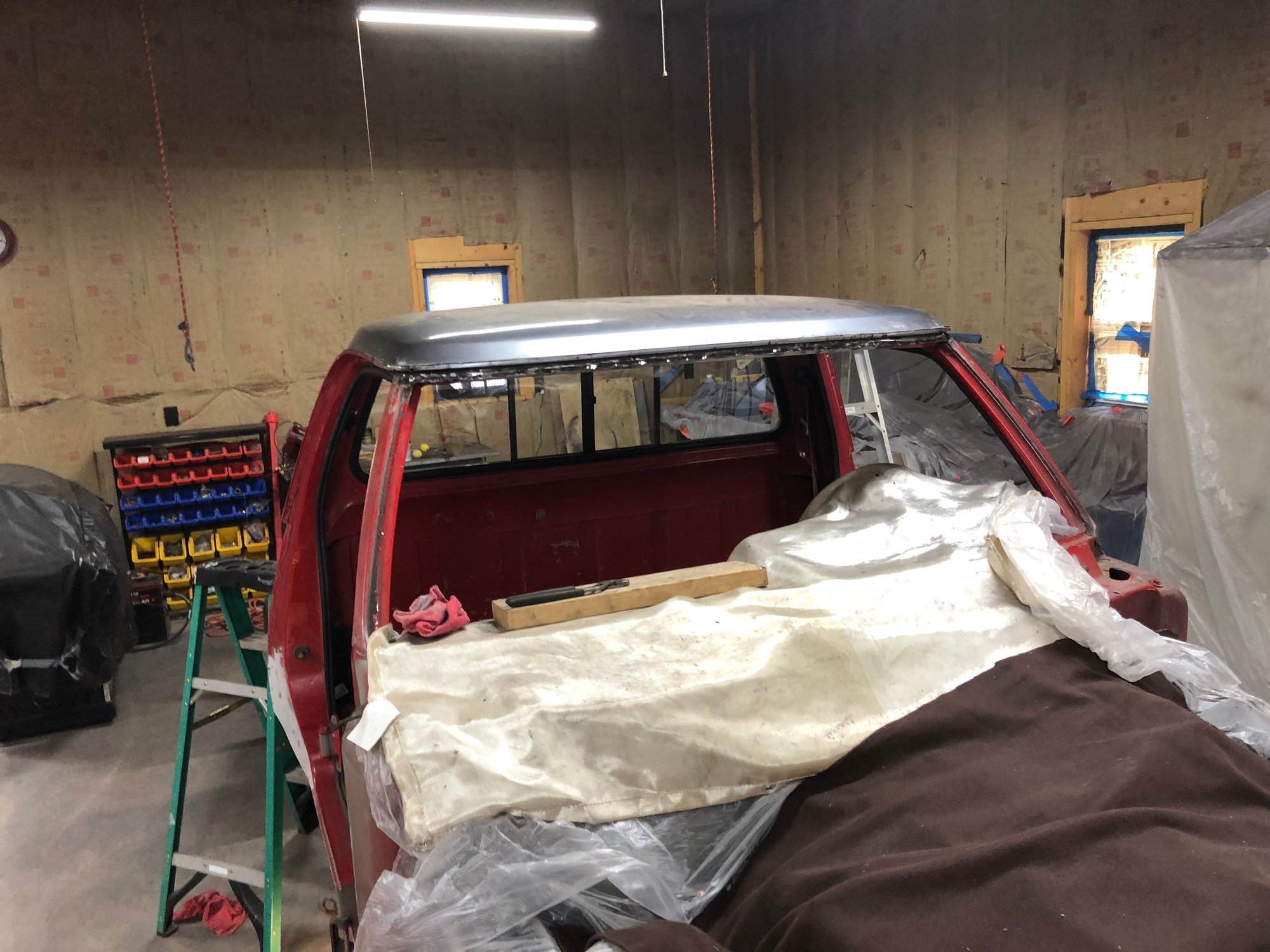

Got the front drip rail welded on and the roof set in place. Hopefully get that welded on soon

How in the world did you get the spot welds to come apart on the back of the roof panel? They look hidden.
Looks very good btw

i cut above the seam in the old roof and below it on the new to expose the spot welds on both panels. Then I drilled out the spot welds and then I had it how it sits
