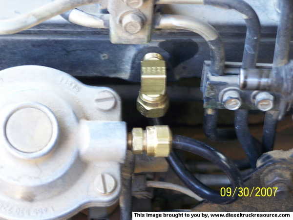

Originally Posted by dieselcarpenter
Thanks for the advice everyone, I chose the DIY route. NAPA had just what I needed. here it is with a parts list.
AFC (air fuel control) boost pressure line repair
1. 1/4 NPT male - 1/4 OD air line coupling, 90 degree, (intake side) NAPA # 1460 x 1
2. AFC matching thread (1/8 inch fine?) - 1/4 OD air line, straight, NAPA # 1468 x 4 x 1
3.1/4 OD black nylon air line, NAPA # D1040401
(no thread tape the brass sealed it right up!)
(the NAPA #'s are off the invoice, may be local, #'s may differ)
Truck acts like a rocket now, escpecially in 3rd at 1800-2000 (compared to were it was).
Hope this helps.

Talking
ok so first of all thank you guys for all of your imput and help. i did the excact idea from the picture above and it is killer fast now!!!! i got the pump and throtle dialed in perfict im hitin 27psi and no more than 1250 on the pyro and thats when i hold it wide open for a mile straight so i think its doin great. Any more imput you guys can give me at all i would love to hear and do. My only question is, the hose that i used to go from the manifold to pump, if i make it shorter would that make it faster? Cause i actualy did it a little differently i didnt use any 90 degree fitings i used straight fittings i was just wondering thanx again
Old 10-15-2007, 01:31 AM
  #14
Chapter President
dieselcarpenter's Avatar
Join Date: Nov 2005
Location: Ridgecrest, CA
Posts: 858
Received 0 Likes on 0 Posts
Glad my repair/ photo could be of use. ( even if BC beat me to posting it, haven't been on much latley) I used the 90 because its all NAPA had at the time. I have heard some guys say that the size of line is a factor and also the length. I am not sure. I know that it is boost pressure related. With water lines pressure and flow are too different things even though they work together, (ie, a closed line will read high pressure but if the flow is low as soon as the valve is opened the pressure drops to almost nothing, air is compressable, that may factor in, a shorter distance may result in less travel time for the boost, but if the system is closed, once the turbo spools up and makes boost the whole system should be charged to same psi, from the turbo outlet to the intake valve, all at the same time. Maybe I am wrong, I know there are plenty of guys here who know more than me, and they will probably correct me, this is just how I understand it to be. Hope it helps!! and I hope somebody sets me straight if its way out there
