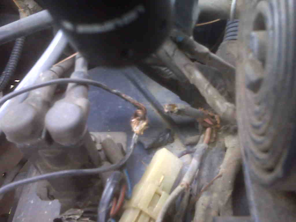

Started tearing the harness apart today.. Someone in the past was a HACK!!!!!
Here is what greeted me when I unwrapped the harness.
Attached Thumbnails Brake Light/Turn Signal/Flasher Failure-fusible-unwrapped.jpg

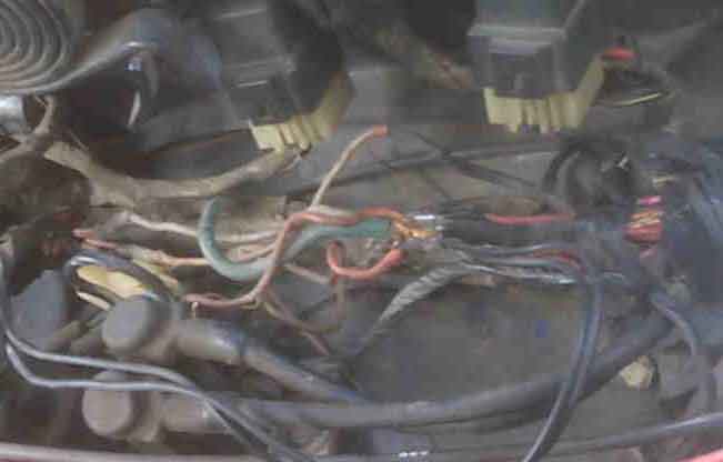

Here are 2 wires that were hacked in instead of fusible links. They were twisted around the brown and pink wires to the right. They appeared to have been sealed with Liquid Nails and then wrapped in tape
Attached Thumbnails Brake Light/Turn Signal/Flasher Failure-img00113.jpg

That reminds me of my '71 Dodge RV... one time the headlights went out on the highway at night. I immediately thought of the dimmer switch on the floor (screwed right onto the carpet)... turns out the previous owners had replaced one of the wires going to it with a length of speaker wire and then just looped the stripped end through the hole in the spade connector on the switch. I would have been upset but I was just glad it hadn't caught fire.
Old Jan 2, 2010 | 07:05 AM
wannadiesel's Avatar
Posts: 22,594
From: New Holland, PA
Sweet! Nothing like a professional wiring repair...
Old Jan 2, 2010 | 09:28 AM
EClancy's Avatar
Posts: 463
From: over yonder back there
i think the same guy did some wiring "repairs" on my trucks......

Success!!!!
Made a power distribution block
Replaced all the fusible links with new links
Replaced Brake light switch
Used a 150 AMP fuse for the Alternator feed
Truck is fixed.
I do have one dilemma:
the front relay has a brown wire that was wrapped to the pink feed for the brake lights, where does this wire terminate?
I also have one feed line to the grid heater to replace, ran out of connectors
