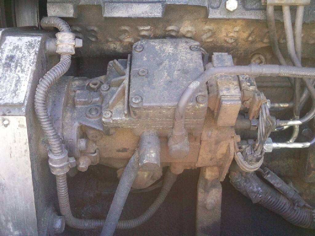

I was working on a 2002 6bt today with a VE style pump that is electronic controlled. It has the larger injectors like the 2 Gen trucks. Thought you VE guys might want to look into it.

That's a VP44. Similar in the way of a rotary/distributor style pump. Pretty much, as you said, an electronically controlled VE. With the reputation those ones have, I'm sure no one wants to bother making one work on our 1st gens. That's what p-pumps are for .

I did not look at all the sensors but I don't think it has many. Nothing in the exhaust. I think it has a flywheel sensor and intake pressure sensor. Dont see a TPS but it could be inside the pump. I have not seen the ECM yet but it is on a log loader/processor. I have to work on it some more this week so I may be able to see more sensors. I would imagine that the ECM only controls the throttle like a governor and aneroid. Wiring is simple. Someone must have replaced the injectors and did not tighten them. It popped number four out. They also neglected to install the injector line brackets on the back three sticks. Number five injector line broke a few days later. I am replacing all three lines and brackets. Had to do a temp weld on the line till I could get one.

THey actually did make a electronicly controlled VE, How do I know you ask? I got one sittin here tore apart, actually some parts made it into the VE I just put together.
