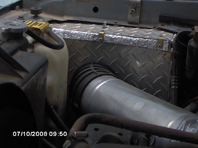

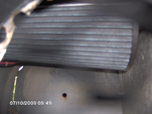

I used a piece of alum plate and cut out the basic shape in cardboard first to be sure it would lay against the wheel well. It was odd shaped and I couldn't cut the shield in one piece, I cut the face then the back end. A couple of 1 1/2" right brass angles out of my junk bin and some aluminum faced pipe insulation along the edge and it looked ok. That filter sure looked better than the stock one and the whistle sounded good too.
Then I got carried away...
Cut it to fit under the edge of the hood lip on the fender, up front against the core support to the right of the headlight, curved it with a file to the fender curve - put aluminum faced pipe insulation along all edges. And then found I had just enough aluminum to make a nice lid for the whole thing - of course the edges of the top were treated to the aluminum pipe insulation also.

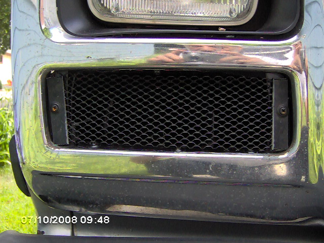

1st pic is air intake in grille, 4"x8" register sits behind the grille and up against the core support that has been drilled carefully to remove most of the center. Not a lot of holes, just one big 5" hole.
2nd pic is the AmsOil filter nestled between the bhaf shield and the fender.

Guess it all works pretty good. A temp probe sitting just in front of the filter shows incoming air temps ~ 10* above ambient - with the engine hot, A/c on, and 35mph in town. On the hiway the temp will rise ~ 5*.
Temps at the gutted grid heater is 20* higher around town if I behave and will rise ~ 50* if I floor it for 8 - 10 sec.
BTW - The inside pipe of standard 6" double-wall furnace exhaust flue ( which HAVE to be air tight at high temps ) happens to fit very tightly over the rubber ends of our stock rubber intake tube. Mine was cracked where the clamps wouldn't hardly hold..A box cutter soon had two pieces that fit inside the furnace pipe and one end over the turbo, and the other end fits the AmsOil 4510 perfectly with a short piece of pvc to stiffen it up so a clamp will grab.
