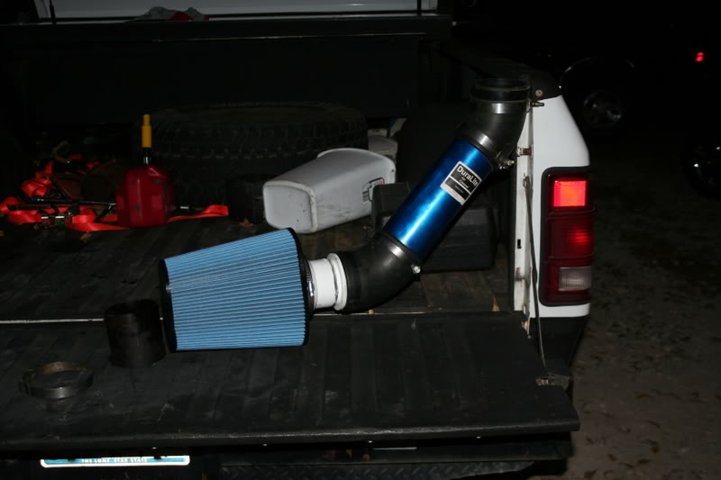

The AmsOil filter looks like this....
PN 4510. Its larger than stock but a bit smaller than the BHAF, and its 1/4 of the weight. The BHAF is certainly a heavier duty filter.
My only complaint is that the inlet on the filter is 4.5" and my BHAF setup(i used to have a BHAF) was a 4". As you can see in the pic I have that bottleneck adapter to get the filter to work.
Granted AmsOil does carry nanofiber filters with 4" inlets but the actual size of the filter wasn't big enough for my liking. The more surface area you have on a filter the more the filter is able to trap and still perform efficiently.
Ive checked O'Rileys, NAPA, Auto Zone, Car Quest, online stores and local plumbing stores and none of them could find me a 4.5"-4" adapter.
If anyone out there knows where I can find such a thing at a reasonable price please PM me. =D
