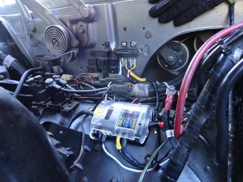

Old Dec 27, 2011 | 10:28 AM
Posts: 6,839
Originally Posted by BILTIT
You are better off adding a distribution stud/block than adding a bunch of wires to the batt. connectors.
I second the motion....
it's a much safer alternative, and your wire ends never get corroded from battery gases.

do you guys run the fuseable link wires thru a power distribution block?njtman,did you delete the fuseable links and use the fuses in the power distribution block pictured?

Old Dec 27, 2011 | 01:53 PM
Posts: 6,839
Originally Posted by cseby
......T
No
I will be adding another distribution block at some time in the future, specifically for the fusable links, as I'm really not crazy about having them the way they are...
I used the distribution block pictured above in this thread..
https://www.dieseltruckresource.com/...k-t298672.html
I have a plow which required extra headlights, controller fuse, etc, as well as changing over my truck's headlamp system to bypass the headlight switch.
It's in the thread.
T.
Old Dec 27, 2011 | 02:04 PM
Posts: 6,839
Originally Posted by Jim Lane
How come you have so much room next to your battery?
... does your fuse block have a waterproof cover that snaps over them?
West MarineI have been past this place when I go to Balboa Island.
Jim
So much room ? I guess I'm just lucky, I suppose. Could you be a little more specific as to where, or what you're referring to. I'm a little dense @ times.
Unfortunately, fuseblock is not waterproof, as the cover has access ports on all sides for input, ground, and the takeoffs for each on either side. The cover is just to keep general stuff off of it and to prevent accidental grounding of the positive terminals.
http://www.amazon.com/gp/product/B00...00_i00_details
According to the instructions on the package, the fuse block (itself) is "supposed" to be isolated with a 125A fuse or circuit breaker, such as this one.
http://www.amazon.com/Blue-Sea-Syste...5016772&sr=1-9
Would be nice if the fuse for the block, was inside the block itself, like a real circuit panel in a home, where you could shut the whole panel down with a pull of a fuse.
I wish it was waterproof, but I guess at some time in the future, I may just have to upgrade to one, if I run into issues, such as you're describing.
West marine sells thie exact same one.... but around $15 more than amazon sells it for.
