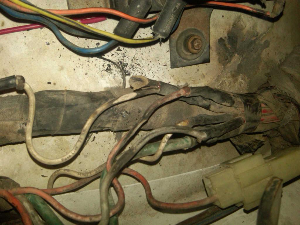

wannadiesel, you were right about the fusable links; cannot believe after all the time i spent looking and scratchn i didn't see this.
Heres what i did but didn't fix the problem, but probably did it wrong. There were (2) 22ga fuse links going from (1) red wire to (2) red wires. I put a 5am 14ga fuse link inline.
There is a header of sorts that several link go into/outof. Do I need to try and tie back into this? Is this a part that I can simply replace all at once? Apologies, I'm not the greatest when it comes to this stuff.

It looks like more than one fried. Pull hard on all of them, if they are cooked they will separate. You've reconnected all the wires and it still doesn't work?

sorry for the delay, but thanks that is what it was. i'm rollin again.
