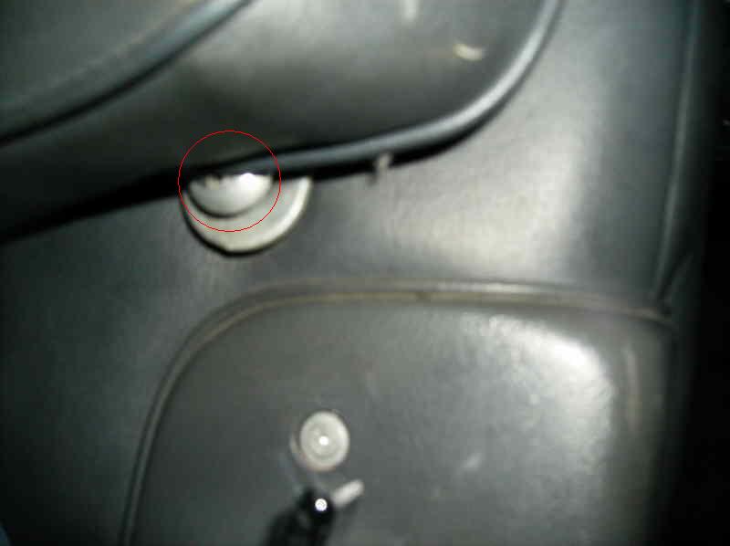

Sorry. I can get those but I'm talking about the arm rest on the seat themselfs. I'm trying to put seat covers on but can't figure out how to get them Bugers off.

You must remove the screw circled in red. Pic taken looking at the passenger seat from behind the console.

Thanx wannadiesel. I don't remember if I seen this screw or not. I will check it out a little closer. Thanx buddy !
