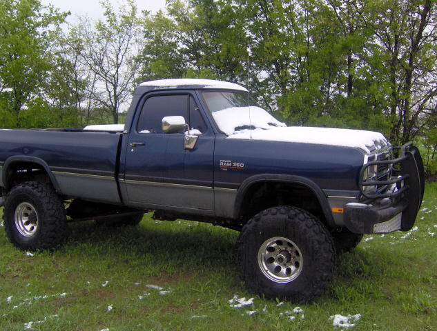

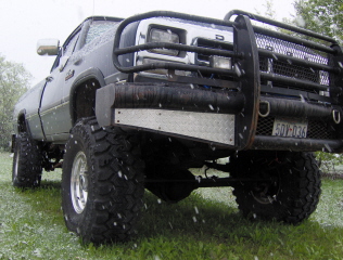

From: Jonesboro, TEXAS
these are 38x15.50 they rub a little with only a 3" body lift.
