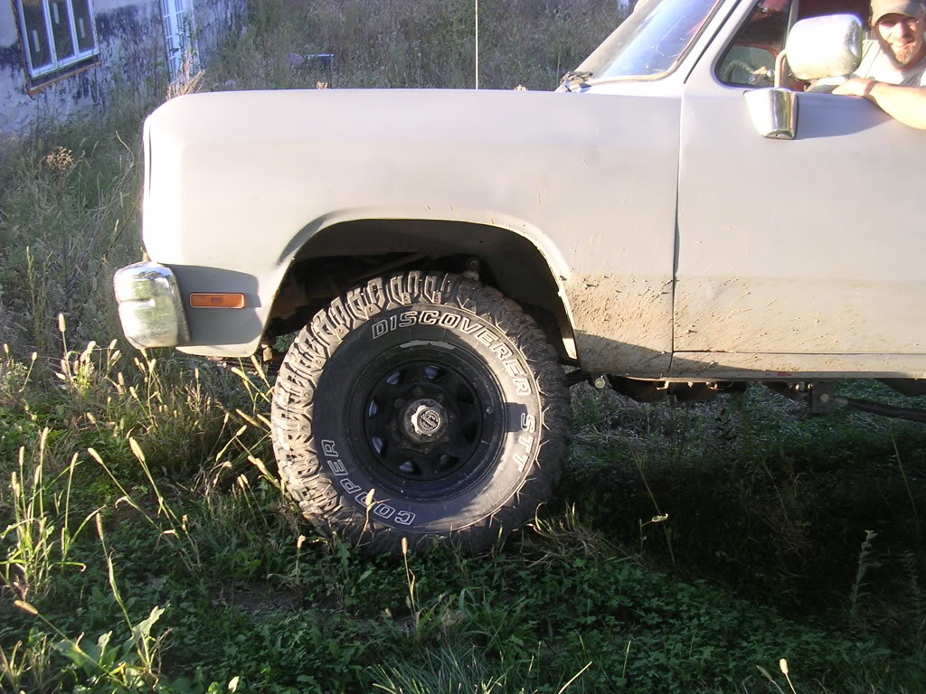

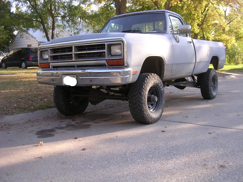

Will guys I finnally got my front springs. I had them built to handle a 200 pound bumper and a winch. Still have to get my drop pitmen arm, the stearing stinks.
Front has 4" Alcans and rough country nitro shocks. The back is the stock springs off of a 1 ton with blocks and Procomp nitro shocks.

The truck rides a ton better than it did with stock springs.

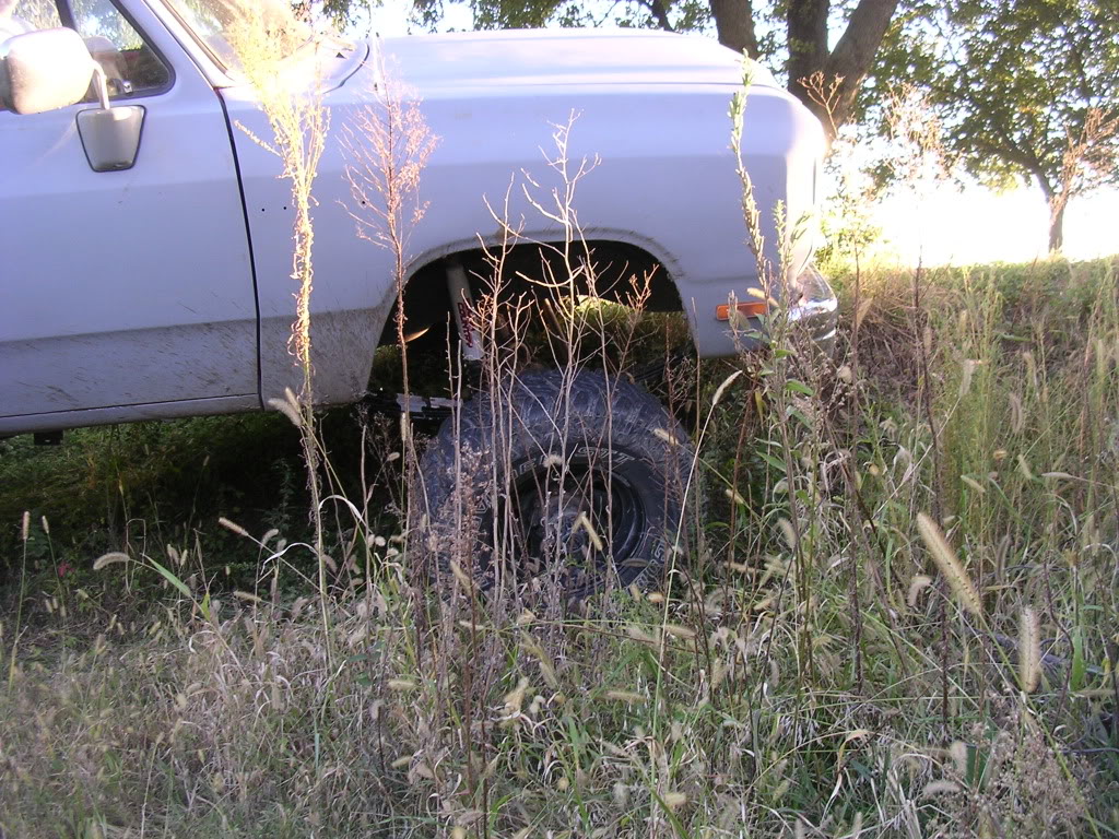

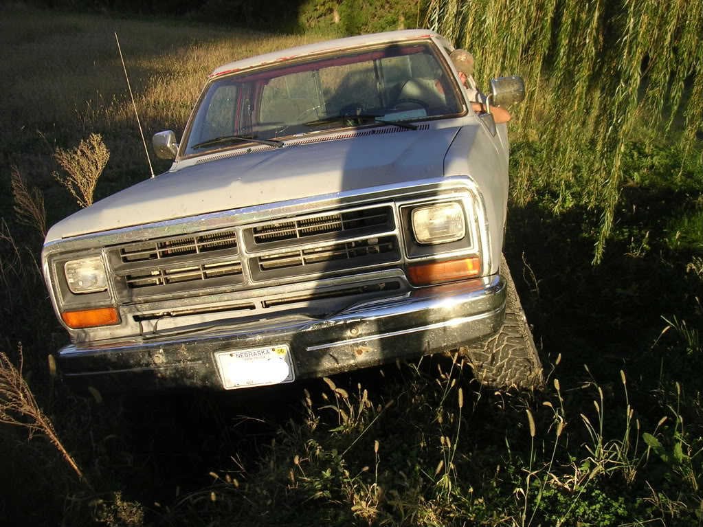

Here's some flexing shots for you. It's not a crawler but not bad for a heavy truck. That's my dad driving.

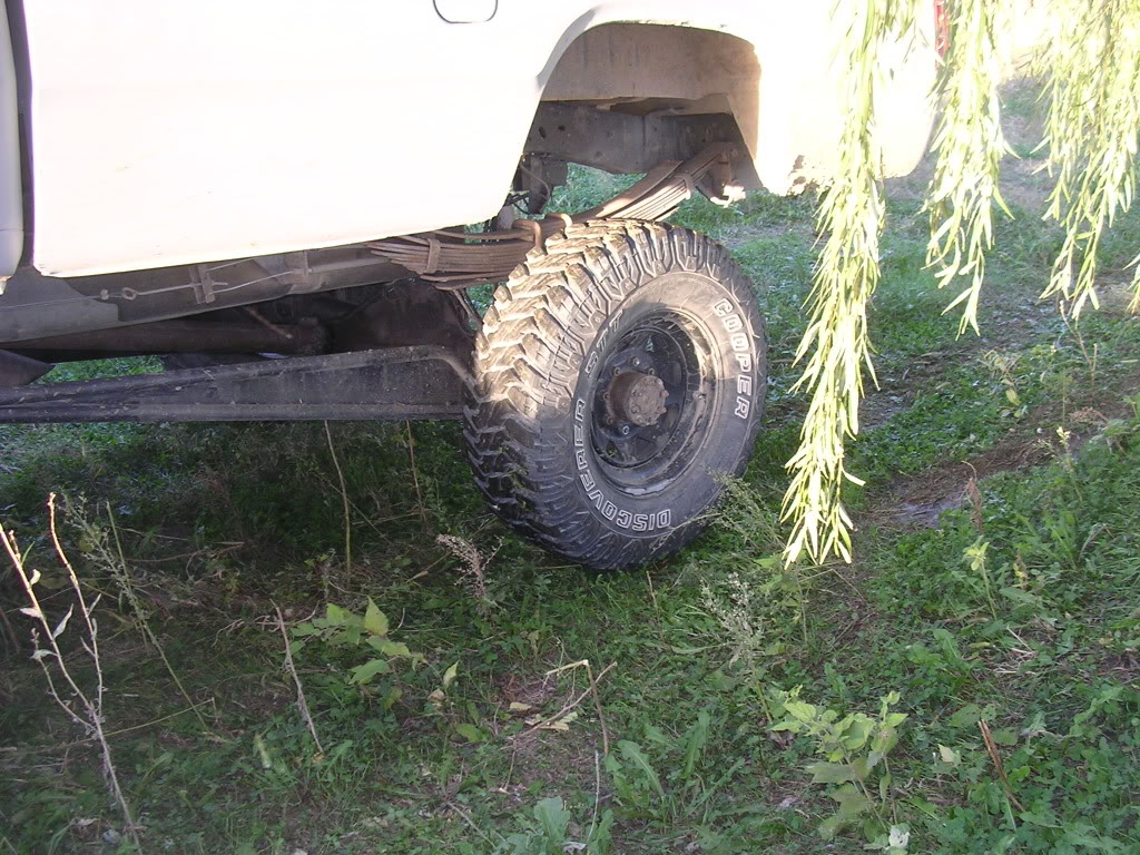

My rears don't flex very well. The tire is off the ground.

My stock rear springs flex alright but then again I don't have the 10 leaf pack + overload spring... Mine is just the 7 leaf rear. Unless you're hauling real heavy on te rear you should tak some of those leafs out of there I can put 4800lbs in the rear with my leafs. It sags but it's still off the bump stops, albeit just barely but still.

I've thought about it but I don't really need it to flex. I live in Nebraska, everythings flat around here. I might still do it if I ever get sick of the stiff ride.

how did the front driveshaft fare flexed out like that in the one pic? alcans look great!
Old Oct 7, 2010 | 07:15 PM
huntinguy's Avatar
Joined: Dec 2009
Posts: 321
That's why I was flexing it, to see if it would come out. It didn't, I was kind of surprised.
