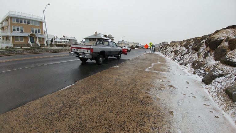

For all you picture fanatics....
Here's me being "broke down"....
