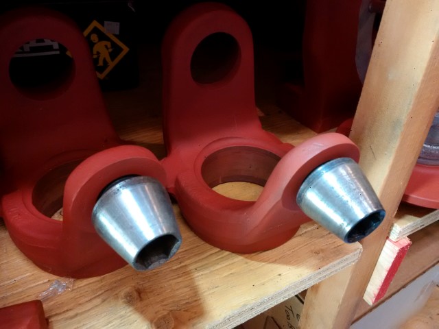

IMO, the spring fatigues, and nylon cup wears/deforms/breaks, before the steel kingpin cone is harmed. You could get some accelerated wear from sand/grit contamination, but everybody greases regularly, right?
Big tires (leverage) and bumpy roads (impact) are jostling that spring loaded joint to some degree anytime the truck moves or steers. Thats a big reason why there's springless setups with bronze cups now.
Here's the cones I'll be using again... (with new nylon cups and springs)
in your pic it looks like you have the ends of the axels off the tubes is that right? As long as you have an axel apart my question is will the king pin fit through the knuckle from the bottom up through the top, in other words can I just take the upper cover off an break the king pin loose and pull it out the top
Not sure - and I can't check as I'm on my way out of town. My cones were too tight in the C's to use anything 7/8" hex to remove them. These are my spare kingpin parts I stripped off a Ford 60.
