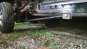

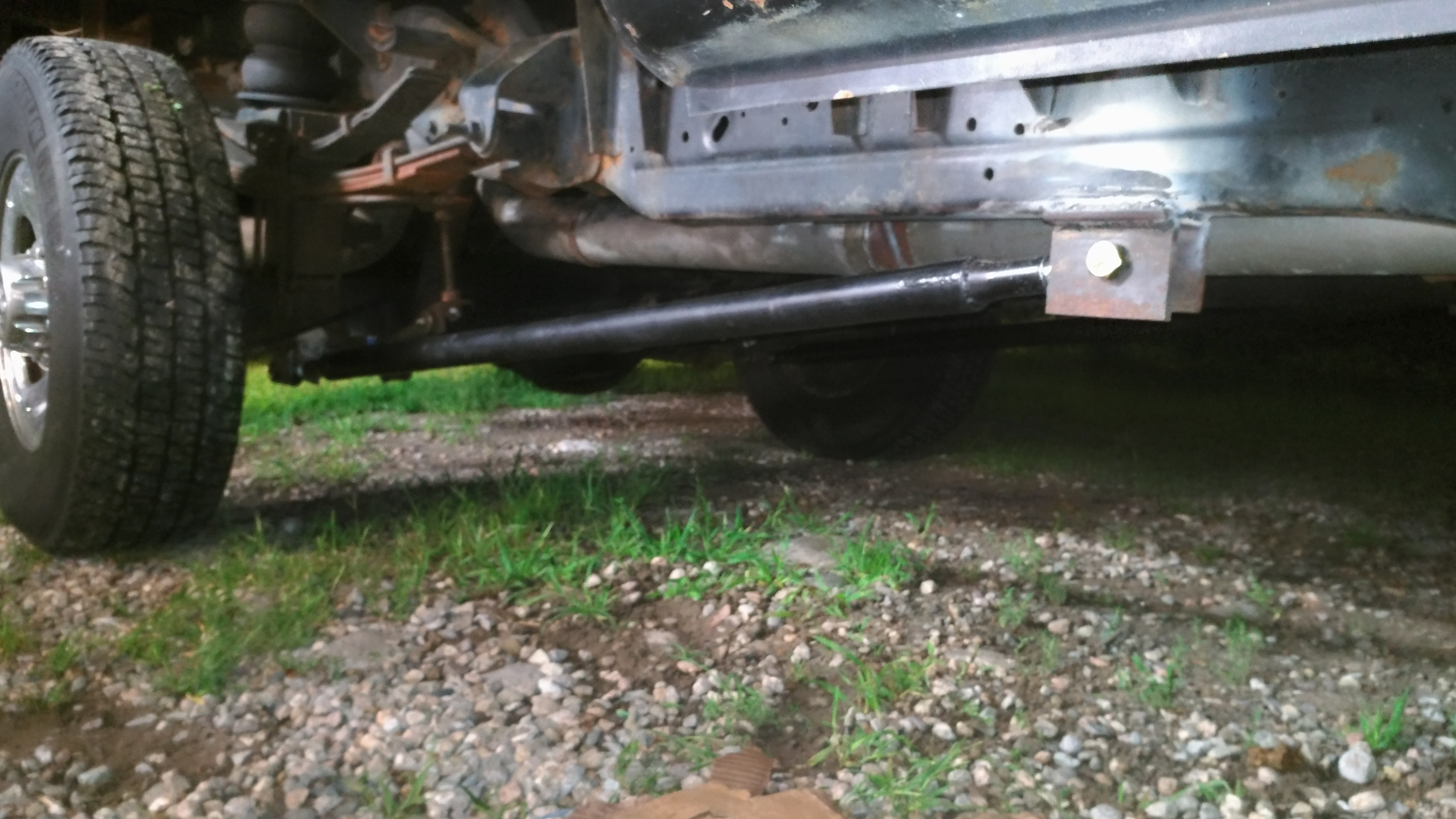

I've had considerable wheel hop since switching to 5 speed, and shortly after air bags.
Started making a basic set of traction bars this past weekend on a budget, Ill let you know how they work. I work the truck fairly regularly, and whether loaded or empty you can feel and see the axle wrap.
So far I'm in it for under $100, not including some anngle iron and flat stock kicking around.

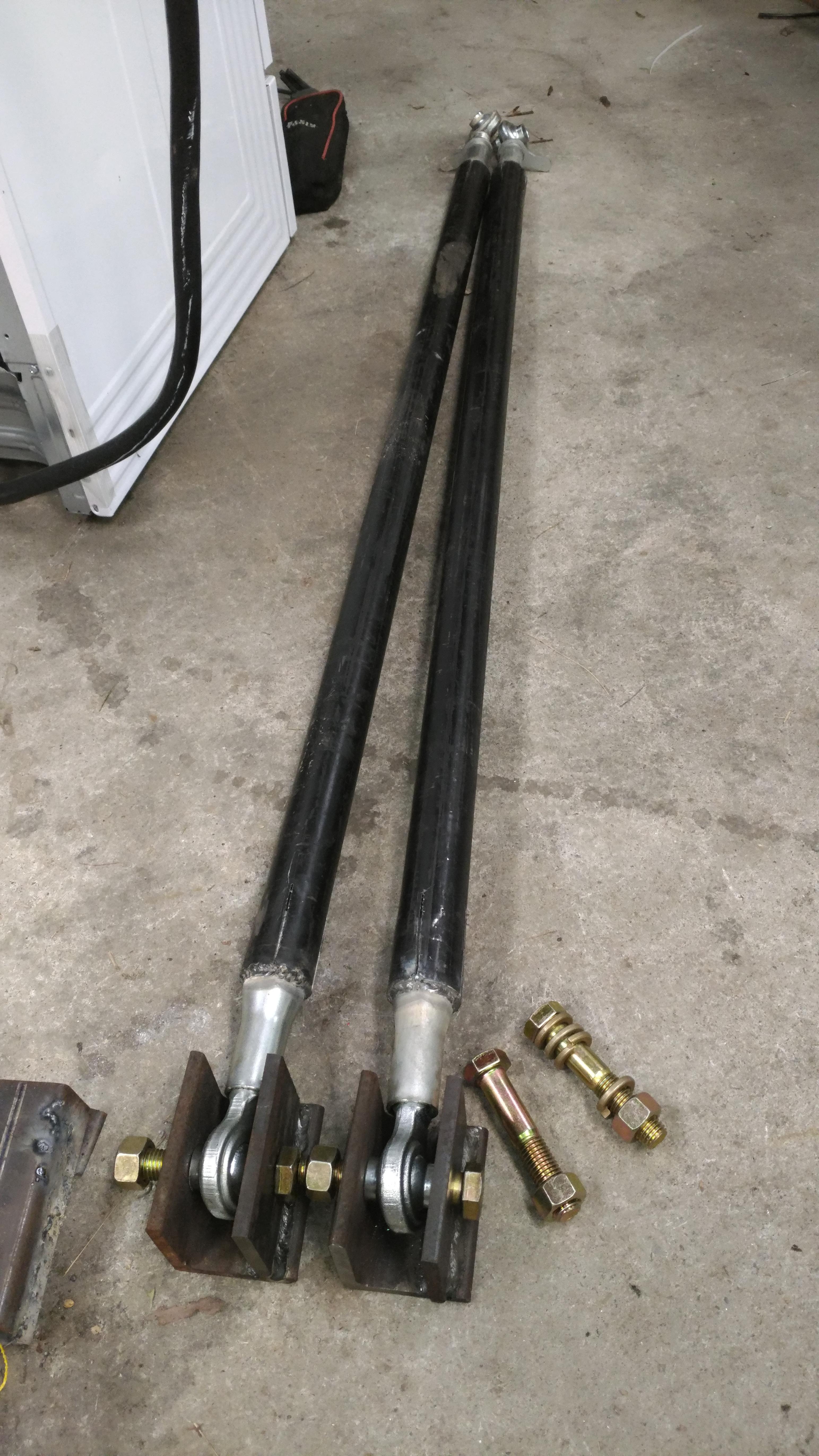

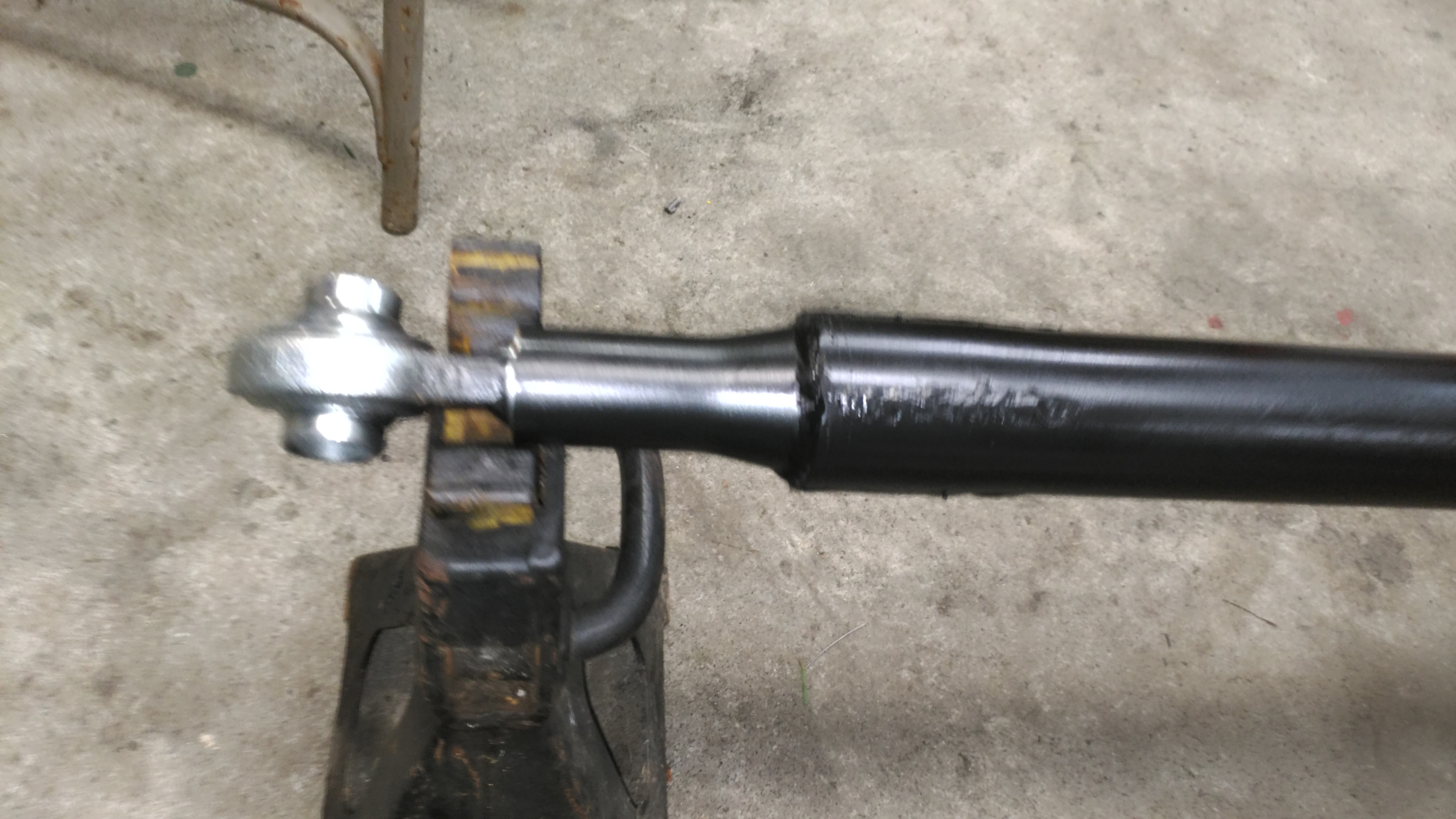

Heim joints from tractor supply, cat 1 top links for 3 point hitch. They were about $20 each and about 2' long completely retracted. 3/4 mounting eye, cat 2 and 3 seemed to have larger mounting eye but same size threads/bars.
I extended the bars with 1 1/2 black steel pipe, plumbing supply variety. Had to slice them open to get it to fit around the heim bars.

Well finished getting everything mounted tonight and took it for a quick spin. Huge improvement over taking off from a dead stop, light or heavy throttle. Did one quick easy 4wd launch and just picked up smooth. I'll report back after some real driving, and of course track time. But so far best improvement for about $100 I've made so far.
