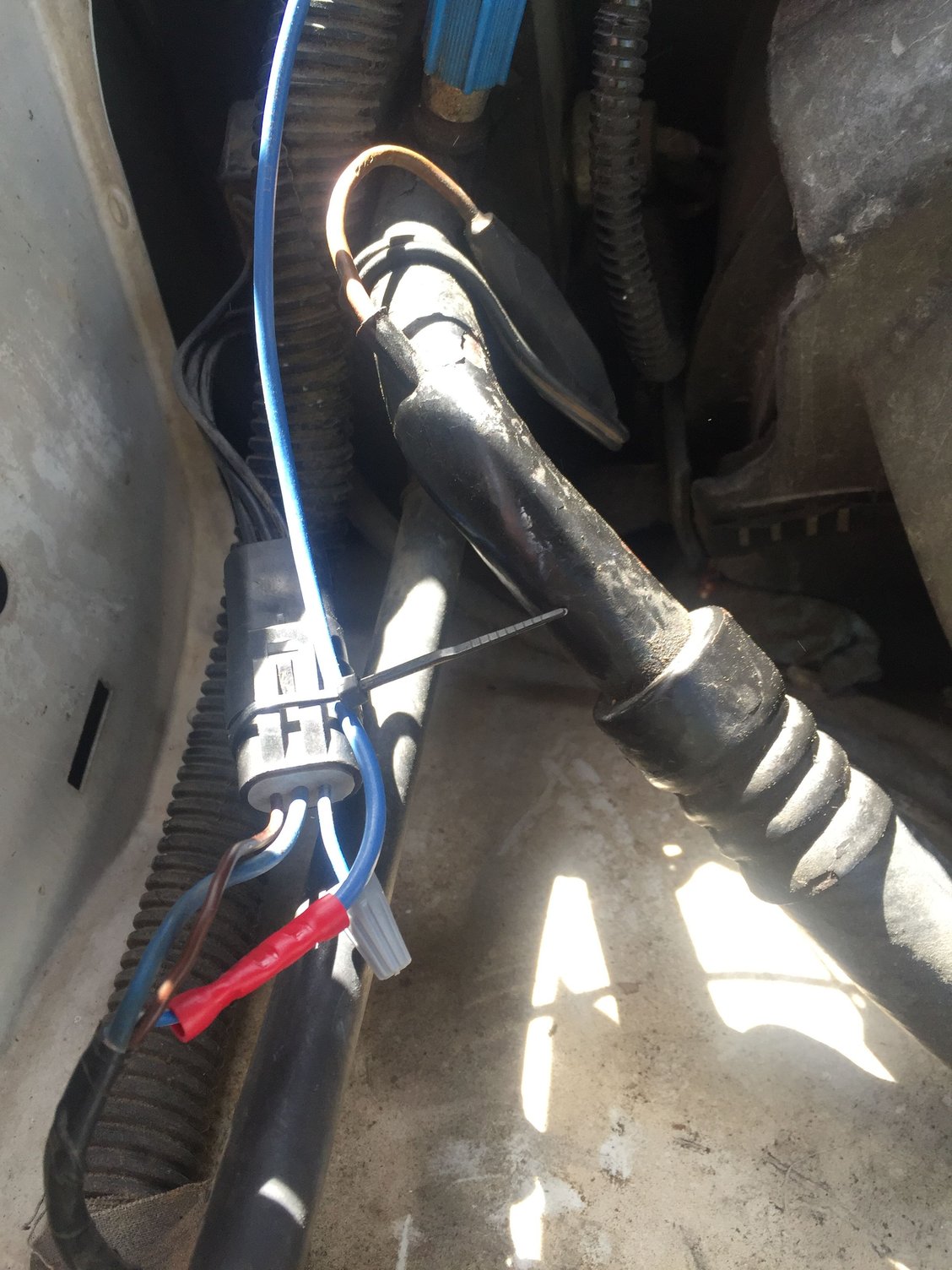

Old May 14, 2016 | 11:17 PM
  #99
HighPlainsDrftr's Avatar
Joined: May 2016
Posts: 19
Likes: 6
From: UT
Intercooled ac cycle switch pcm bypass Method
Decided to upload these to show which wires to cut and splice.
Hooked into the blue and orange wire on the ac relay
Hooked the other end into the blue and white wire on the ac switch.

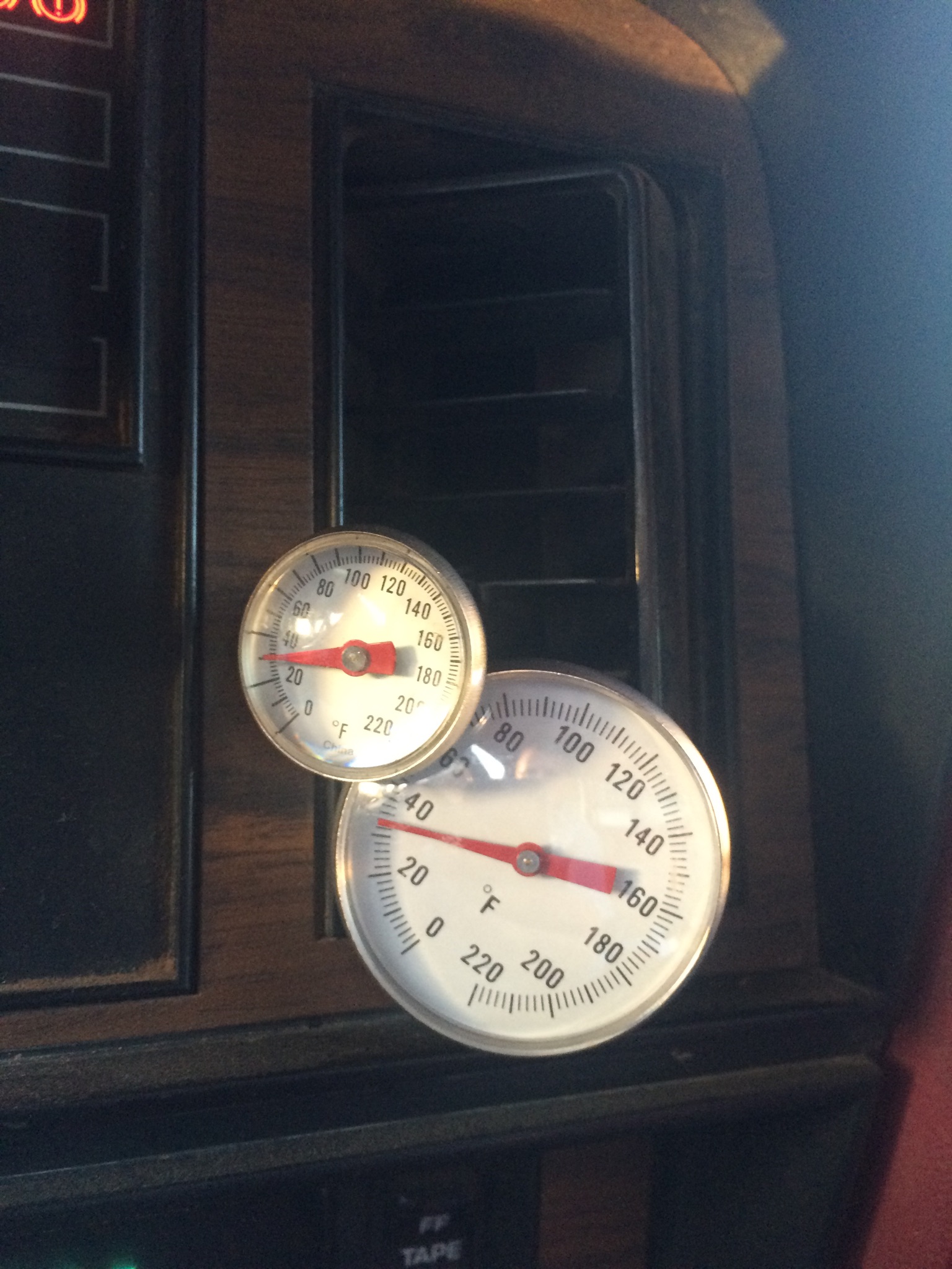

My compressor is on a toggle switch. I control it. Works pretty good. Mine has been that way 2 years now. That pic was took when it was 90 outside. Only gets about 40 degrees when the outside is over 100.
