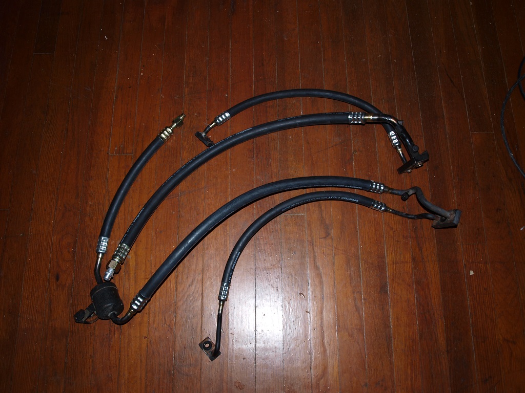

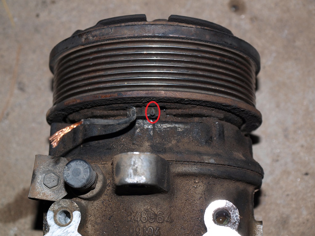

Well my freon recovery stuff came in and I got the system apart. I am converting to 134A, so I had new hoses made. I read that 134A will seep out of the old hoses, don't know if it's true. but after nearly 300k miles, they should be replaced anyway. I found my intermittent cycling, could not have broken off any closer to the clutch. Tomorrow, I am going to flush the evaporator and condenser and put her back together...Mark
Attached Thumbnails AC cycling on and off-broken-wire.jpg   AC cycling on and off-new-hoses.jpg
