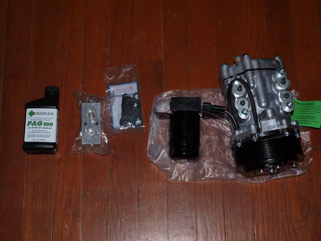

Well, the new compressor kit came in. That guy in SD charged me 30 bucks for next day, shipped yesterday, in my house today by 8:00 A.M.. It is made by Behr-Hella, certainly a good brand name, but made in China (bummer). It does seem to be quality, the connectors are exact and the filter dryer looks factory. Does anyone know, When I evacuate the current r-12 system with the freon recovery machine, does that remove all the oil that is currently in there?...Mark
Attached Thumbnails AC cycling on and off-box-parts.jpg   AC cycling on and off-parts-use.jpg

It will remove the oil that is mixed with the R12, but not the oil still in the evap. condenser, compressor, drier, etc.
Oh, and R410 is what is in my new A/C system at the house. It is supposed to replace R22, not R12.

Thanks, what is the best way to get the rest of the oil out? The compressor, H-block and filter dryer are all new....Mark
Old Jul 2, 2013 | 04:30 PM
rrgrassi's Avatar
Joined: May 2012
Posts: 362
You will need to flush the lines. Then replace with new R12 oil. Look into BG Fridgiquite oil also.

I am converting to 134-A. Am I correct in thinking that most of the non-vapor oil is in the compressor? I found one site that says that up to 2% mineral oil left after a conversion is acceptable and will not affect performance. Another said not to use solvent, because any of that left will cause problems. I am considering Just compressed air into all the open lines, without solvent. What do you think?,,,Mark
