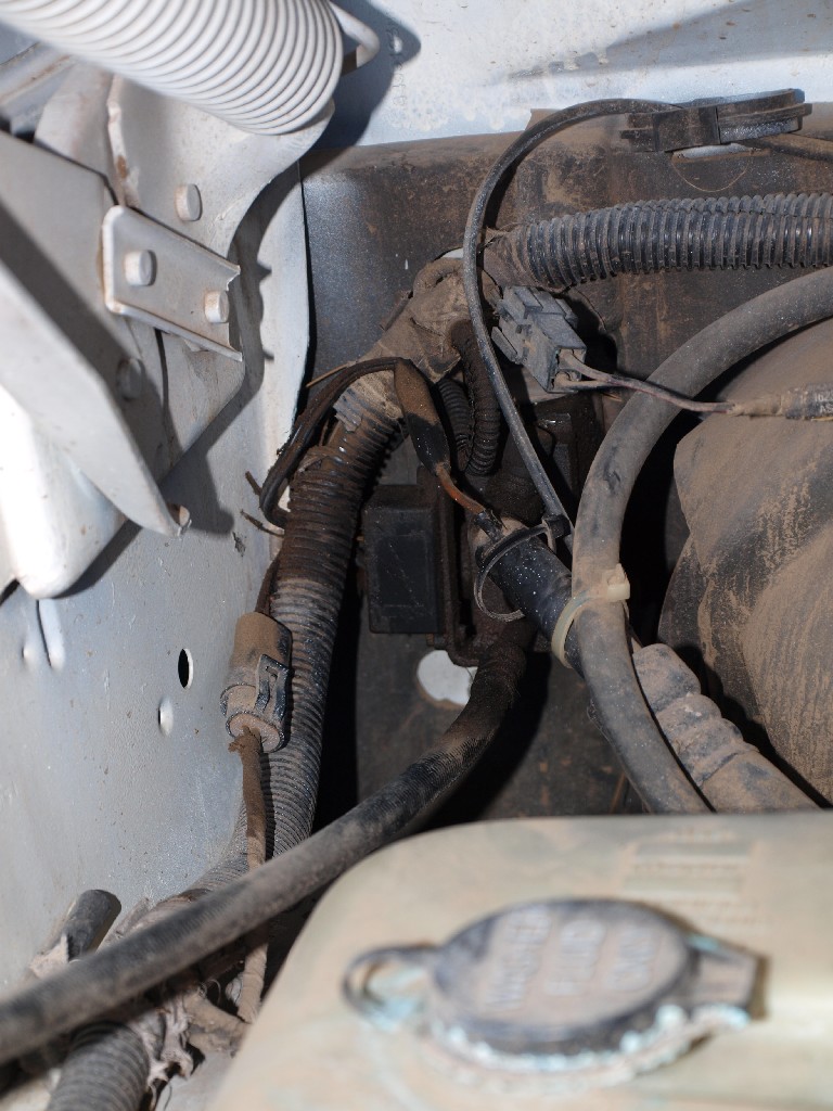

Hey guys! I just got back from Mexico and the air was working beautifully as usual, but when I was within 10 miles or so from my house, it began to blow hot. After I unloaded my stuff, I popped the hood to find the compressor not locking at all, but after sliding the temp/thermostat switch back and forth, it started cycling on and off. I messed with it a little more and it kept going, the cycling stopped and it blew icicles again. It is obviously not low coolant because of that. Has anyone seen this? Could it just be a dirty contact? Has anyone tried taking it apart to clean it? And lastly, Is it available? It looks the same as thousands of cars I have seen (I have told myself a million times to stop exaggerating ). Any suggestions are greatly appreciated...Mark

Thanks Exekial and Jim for the fast responses. I thought about my question and realized that the sliding switch does not do anything if the "max ac" button is pushed in, Is that correct? Jim, there is a block looking thing attacked to where the lines enter the cabin, is that the switch? Can it be replaced without blowing the charge? Is this what the sliding switch actually controls? Sorry for all the dumb questions. It is a 90 and this is between the R fender and the plastic fan motor case thingy...Mark
Mark,
Yes that it is the switch,
If this is the problem,
Yes the switch can be removed/ replaced without discharging the system, the thermistor probe slips into a well welded into the suction line and simply pulls out.
There should also be a low pressure cutout switch with 2 wires on the fender side of the block, make sure the wires are connected securely and not just hanging there.

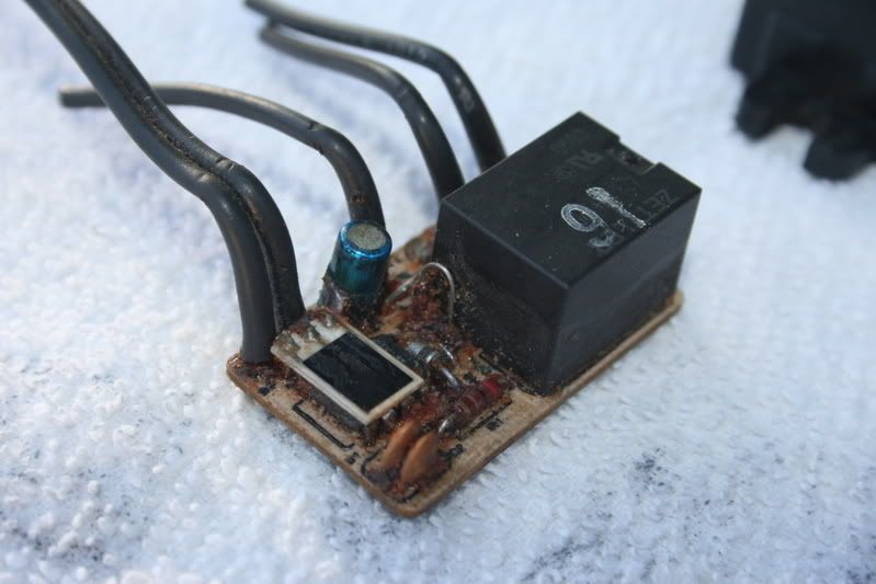

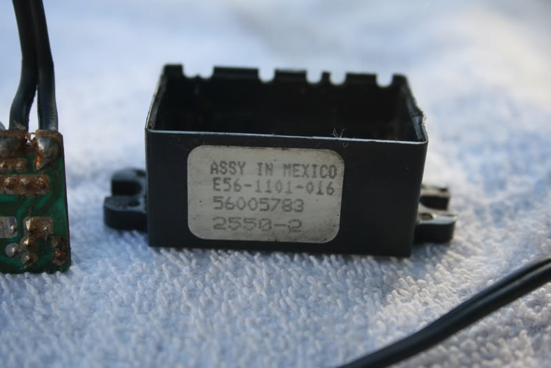

Here is what the inside of the cycling switch looks like.

The inside selector switch provides a ground signal to the cycling switch that in-turn applies cycled signal to the clutch coil to prevent freeze up.
I know the dealer does not have them anymore but something might still be available online.

Well, I set out on a search for this part and found exactly 1 place that has them, so in a very selfish way, I made sure to order mine, and then I will share the source BWAAAHAAHAA . He says that he has several more so go at it:
Thanks, Bob Schaetz @ East Texas Auto Air & Glass
1019 West Marshall Ave.,
Longview, Texas 75604
ph 903-753-0089
fax 903-753-0076
cel 903-720-1922
Part #E56-1101-016 It was 34 bucks plus 9 bucks shipping to Phoenix ...Mark
