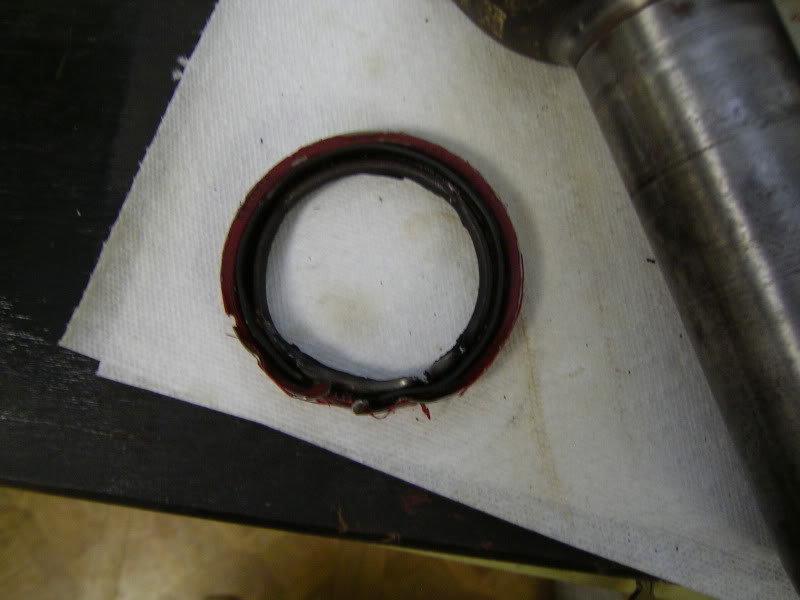

Anyway the rear tailshaft/output shaft seal was leaking badly so I pulled it out to replace. I figured it wouldn't be a big deal to find this seal at one of the local jobbers BUT they can't find it.

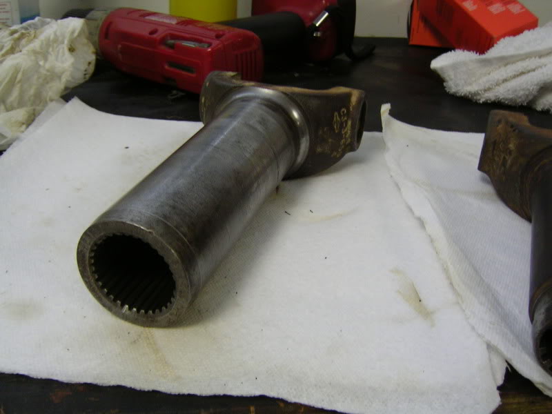

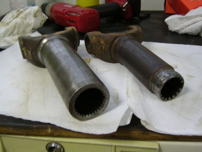

This thing is HUGE, I have never seen a yoke and output shaft this beffie before. I had them pull out every output shaft seal they could cross reference for the 96 NV4500, from 2500-3500, and none are even close to fitting.
Here are a couple pics....

This is compared to the rear yoke on the steady bearing.

Here are the measurements of the seal, OD is 3.023 in and the ID (using the yoke) should be around 2.192 in.
The numbers off the seal are, 68095-J and 4531216 (mopar # ?)
Any help will be muchly appreciated.

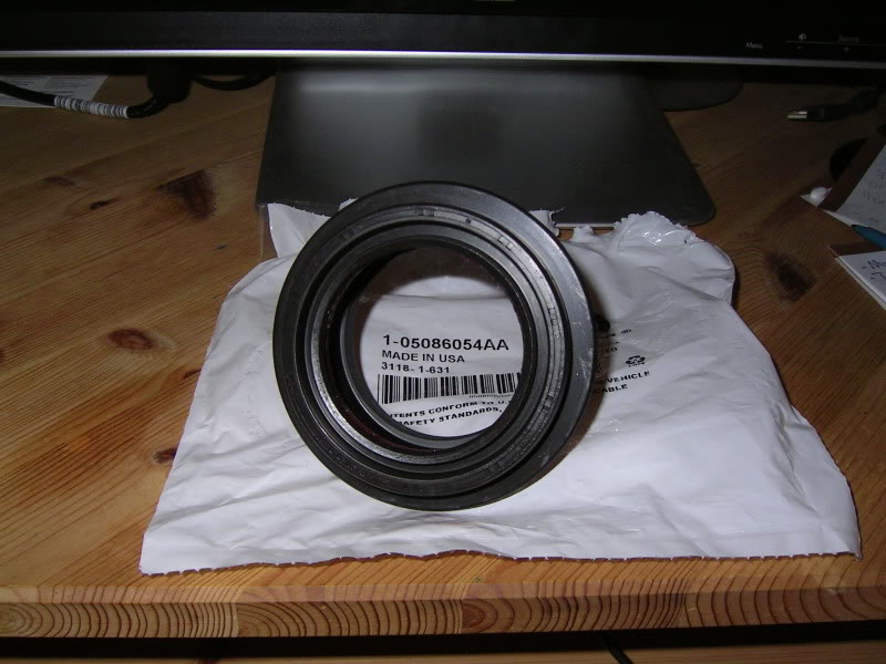

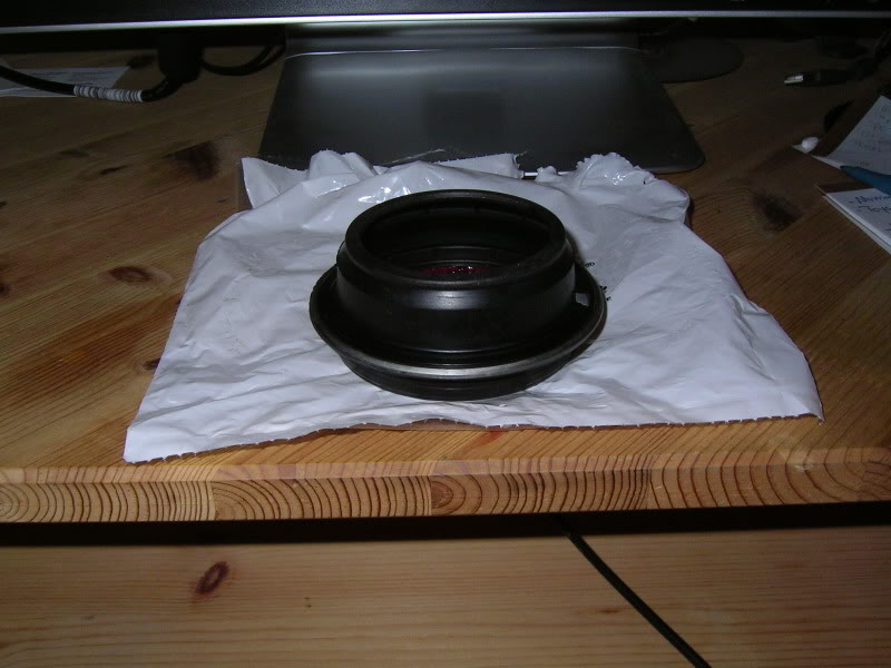

Well I went down to check out the "other" seal. It appears to be the right one!!
Here is the part number if anyone needs one. This is for a 1996 NV4500, 2wd transmission. Tailshaft/output shaft seal number, 1-05086054AA, or 5086054, the AA is a superseded part number.
