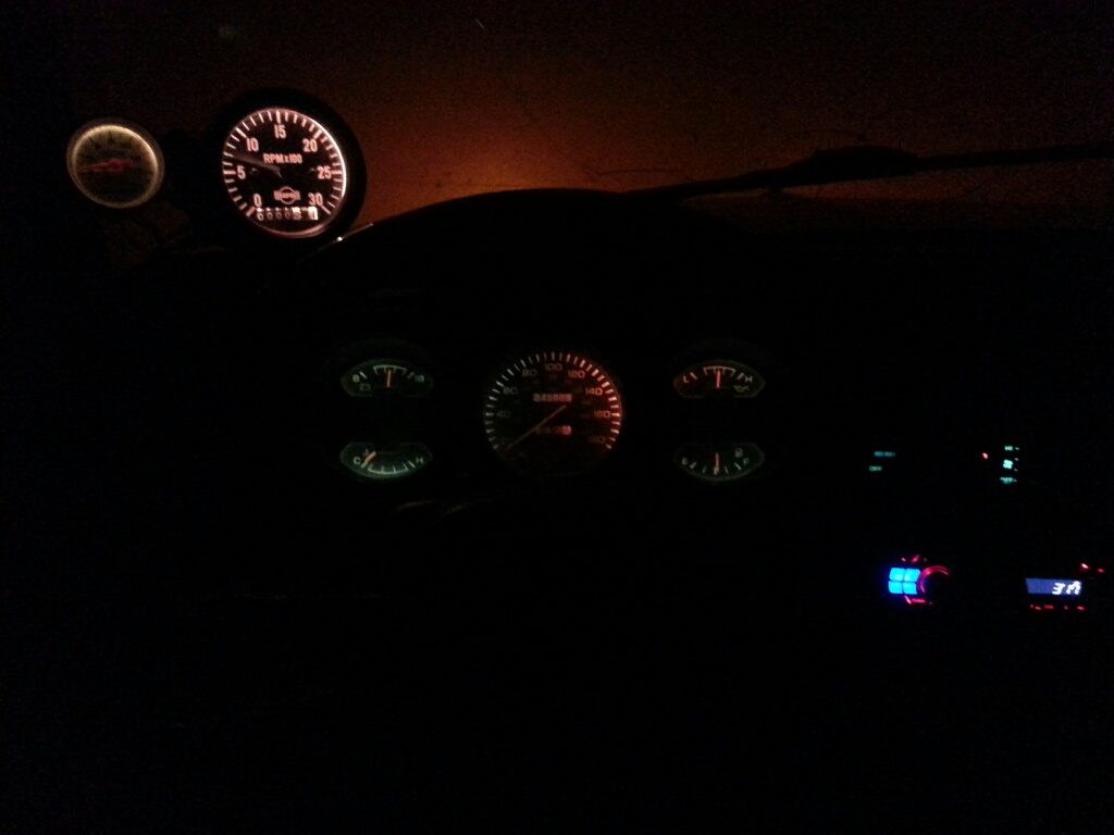

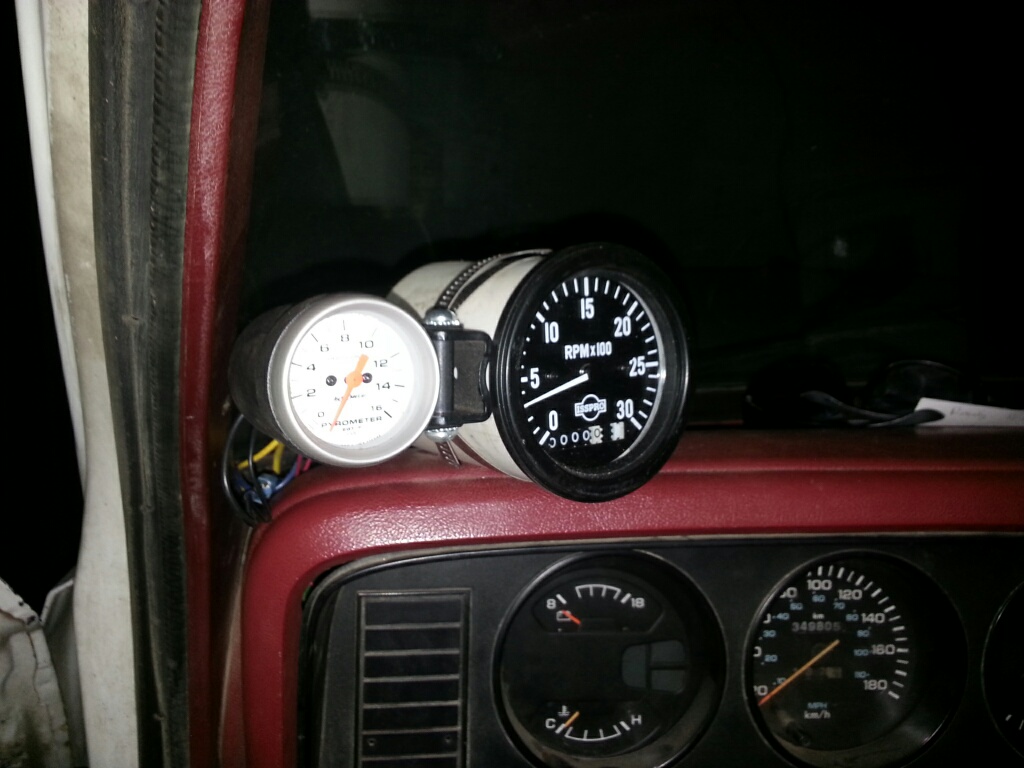

I'm using a 3-3/8" isspro w/hour meter off that harness. Set the dip switches for 2 pulses per rev. Seems to be somewhat accurate although it has a significant flutter at idle. I could probably correct that with a capacitor or some other filter.... or I might just mount a dedicated pickup to read flywheel teeth.
